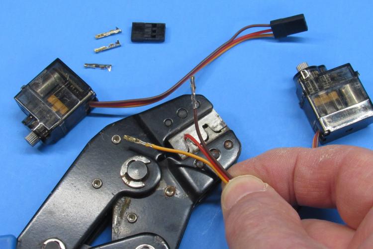

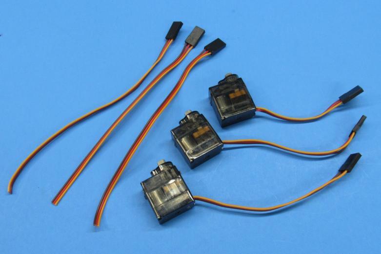

    I crimp where possible, WEGO connectors or similar for PWR/GND buss's.
    To save space, I pull the plastic insulator off the appropriately sized butt splice's, crimp with a non-insulation Terminal crimper, and use Moisture proof Heat shrink instead.
    For the record, that includes the combo solder heat shrink splices Bob loves....yuckie!
    Non-wet crimping. In this case to reduce all the loose 'spaghetti' within the dry spaces.
