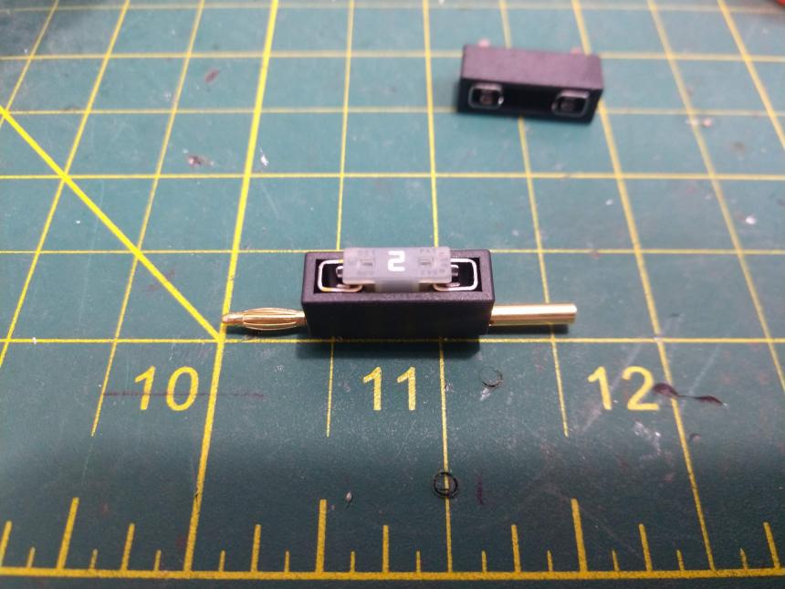

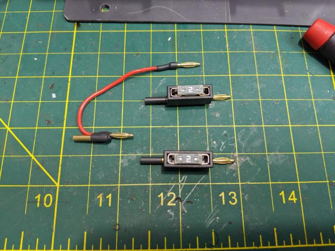

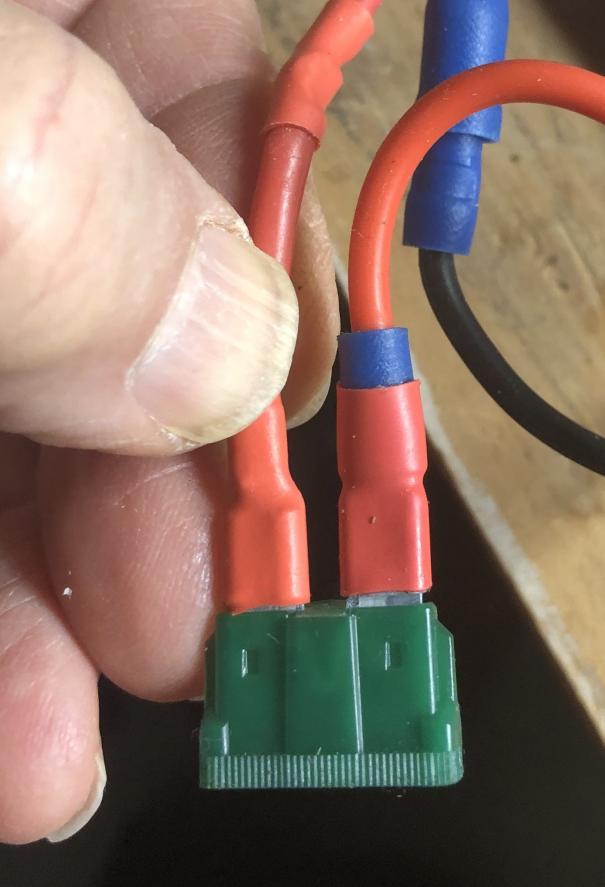

    In addition to the small size an flat shape of these fuses, the coolest thing about them is that the 3/16" Female Quick Disconnect Spade Connectors fit snugly on the fuse terminals.
    A little shrink wrap and you're in business. Plus it is easy to disconnect and reconnect them.​

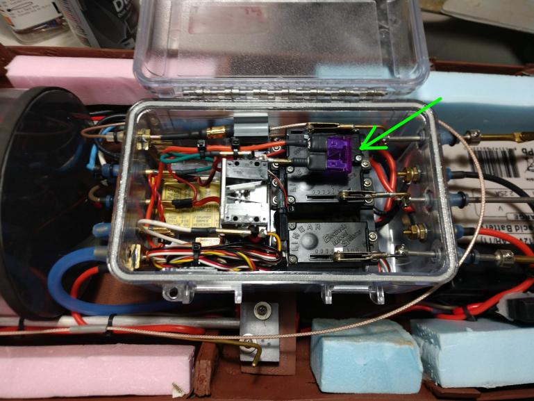

    Go even smaller....
    LP Mini
    Automotive fuse

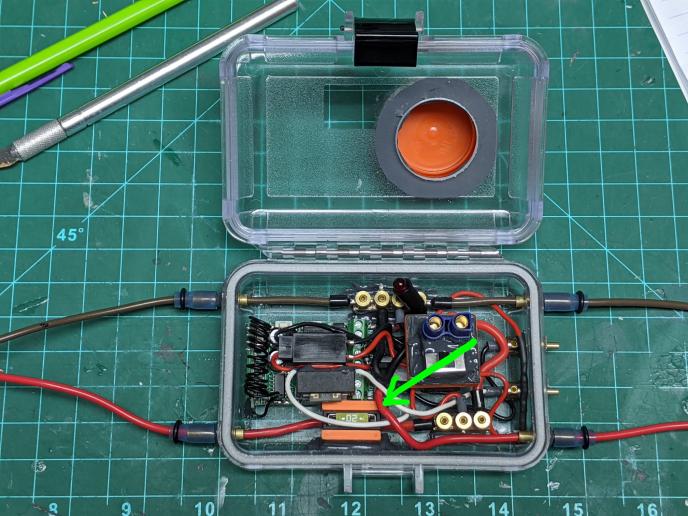

    BUT!! If you have the room, Capt Depth is a 100% spot on! No need for a fuse puller to change. I don't know about you, but the sausages I have on the end of my meat hooks have a tough time removing the LP Mini from the holder lol.
