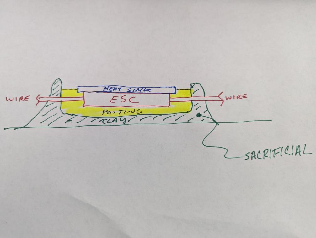

    BTW, that ESC in the video with the exposed Al heatsink? Unlike him, I would imply pot it in a shallow tray, heatsink up carefully adding the compound up to the edges of the heatsink facing up to expose that entire face to nice, cooling water! You could do it in a clay form ensure all wire leads get covered. Then remove the clay.
    Click image for larger version  Name:	PXL_20231008_214358336.jpg Views:	0 Size:	45.3 KB ID:	174663
