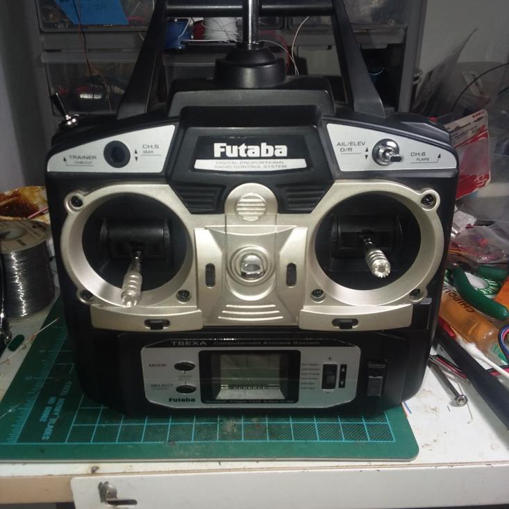

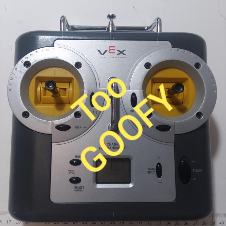

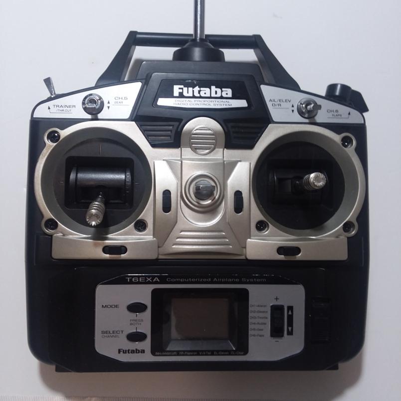

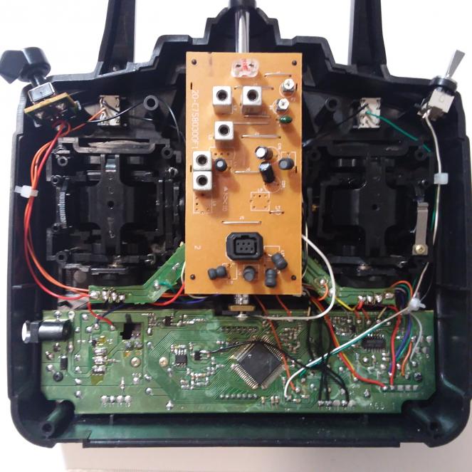

For those who think the VEX transmitter is too goofy and doesn't has the "normal " transmitter feel.
Find its long lost cousin and 2 three postsision switches.
Remove all switches and pwb.
transplant all the goody ( RF and the main board ), battery connector, new standard crystal socket, remove trainer socket and new switches.
New look.
why not just use the Futaba TX as it is?
No 2X 3 postsision switches and is a "72mhz "
WHY?
I Need something to do.
Find a a VEX deal that I can not refuse from eBay, it just too cheap.
The VEX just too goofy.
Open up for more crystal frequency options.
Feel better in hand , for someone with normal fingers (mine too Stumpy), adjustable sticks high and batter trim buttons.
options for switch, gas boat may need a momentary switch and pump boat stationary switch. etc...
