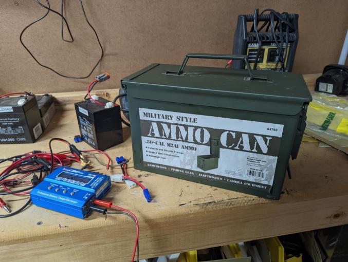

    This past Dive Tribe meet, the discussion turned to the unintended fireworks display at SubFest 2022. A LiPo(s) cooked off during a charge evolution. Someone else here can give the exact details of the event as I was across the pond and was privy mostly to the sound of the event. Thankfully no one was hurt other than perhaps some underwear changing, and of course being who we are had a good laugh afterwards.
    That lead to the discussion regarding the safe practice and storage of the ubiquitous LiPo.
    Capt Martin explained has an ammo can with a 1" [25mm] hole drilled in it (correct me if I'm wrong Bob) to not only pass the charging wire through, but to vent gasses should there be meltdown of the precious "reactor" charging within. Excellent idea for the charging station! I would also add a rubber grommet to prevent chafing of the charge wires if he hadn't already.

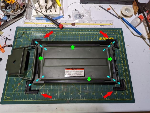

    First I completely removed the Gasket as was suggested, I did not like that as the latch was too loose for my comfort. So I reinstalled part of the gasket in the following manner....
    I cut the four corners ~ 1" [25mm] from each comer, and reinstalled the longer midsections on all four sides. This will allow the lid to space properly off the can, provide the compression effect of the gasket to the ensuring the latch holds properly, all the while allowing unwanted gas to escape at the four corners.

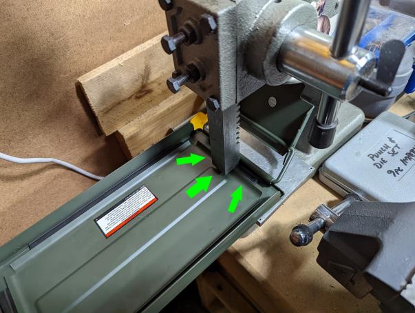

    The piece by the latch side, wasn't held in very well by that angled sheet metal. So I used my Arbor press to persuade it to do so by forcing down the angled sheet metal some more. The other 3 pieces held fine.
