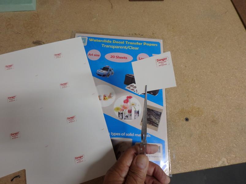

    First layout your subject larger than finished size (actual percentage doesn't matter, it gets changed later)-I did these 40% bigger. I used a word document program for the lettering...Then I hand drew in what I couldn't get the program to do. That's why it's done bigger, then its test shrunk down to actual size and noted what percentage of reduction is necessary. I then go down to the local office supply store(Staples) to have their print and copy shop reduce the master, again when I was happy with the size, I handed the technician a waterslide decal sheet, supplied him with the settings and asked for 8 copies on one page... I use a B&W home laser printer and I wanted the sign to be red. The commercial printers can "color shift" the print subject, so I had them shift this print to red (earlier, I had the other Atlantis logo graphics color shifted to blue)

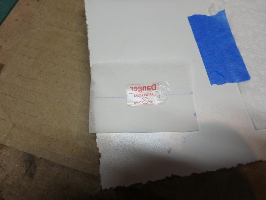

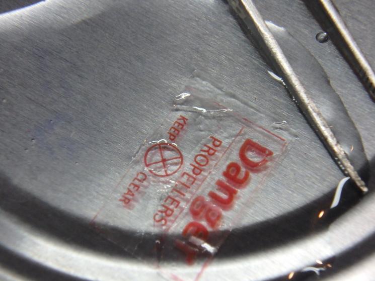

    Take the decal and with water separate it from the backing as usual...lay it out on a paper towel GLUE SIDE UP and wipe all the glue off the substrate. I then laid it out to dry on a piece of parchment paper to dry...

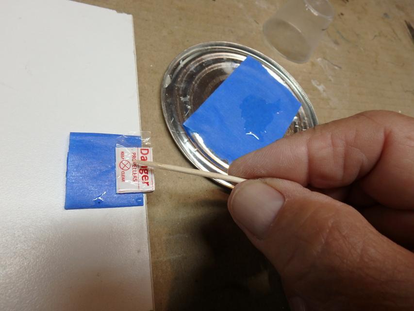

    I mixed a small batch of clear casting resin and used it to glue and topcoat the dried decal (minus its glue) to the sign board...WATERPROOF GRAPHICS-BG​
    Click image for larger version  Name:	PA170002.jpg Views:	0 Size:	47.7 KB ID:	165694Standard waterslide decal sheets and test copy and printed decal sheet
    Click image for larger version  Name:	PA170003.jpg Views:	0 Size:	53.5 KB ID:	165695add water and slide the decal off UPSIDEDOWN -so it wont stick-then wipe off any remaining glue with a paper towel
    Click image for larger version  Name:	PA170005.jpg Views:	0 Size:	42.7 KB ID:	165697 set out to dry on parchment paper..

    Click image for larger version  Name:	PA170006.jpg Views:	0 Size:	48.4 KB ID:	165699 use the resin as the glue and topcoat

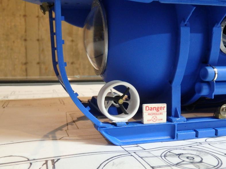

    Click image for larger version  Name:	PA180003.jpg Views:	0 Size:	52.4 KB ID:	165700 Those little things that add realism...
