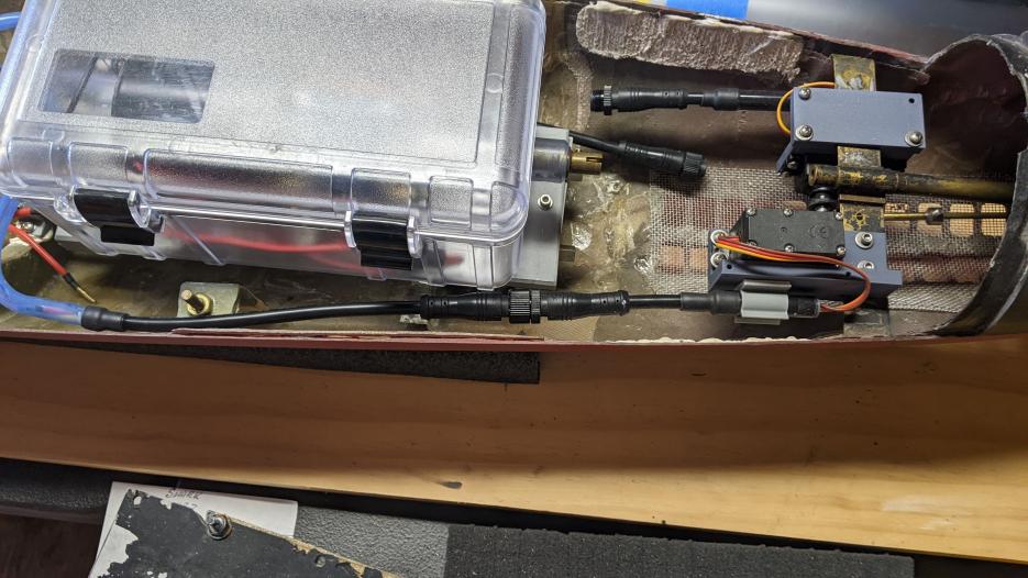

    This servo is a game changer for us, even at it's price!
    So now that it's confirmed that these servos (at least one sample) exceeded its specs enough for us...

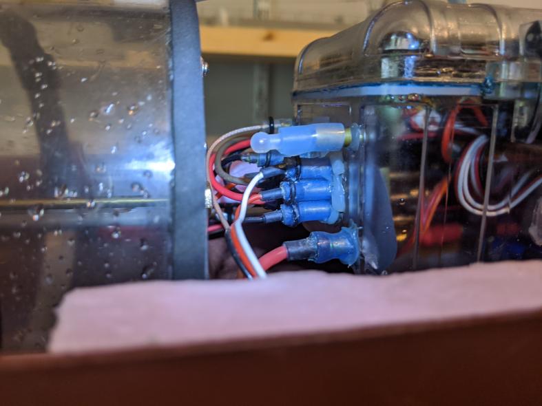

    What do we do about the electrical side? Connecting to the RX via a waterproof connector.
    I used the two following methods (pictures).
    So my question to all those out here, what else can we do?
