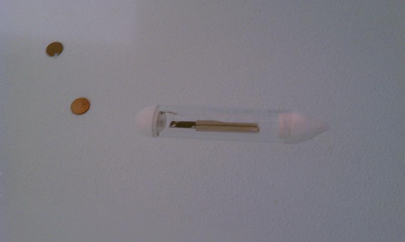

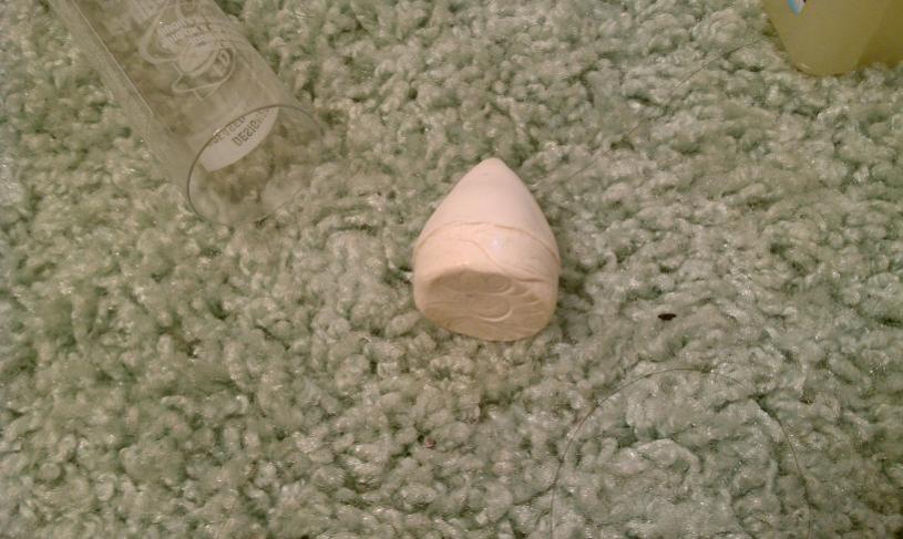

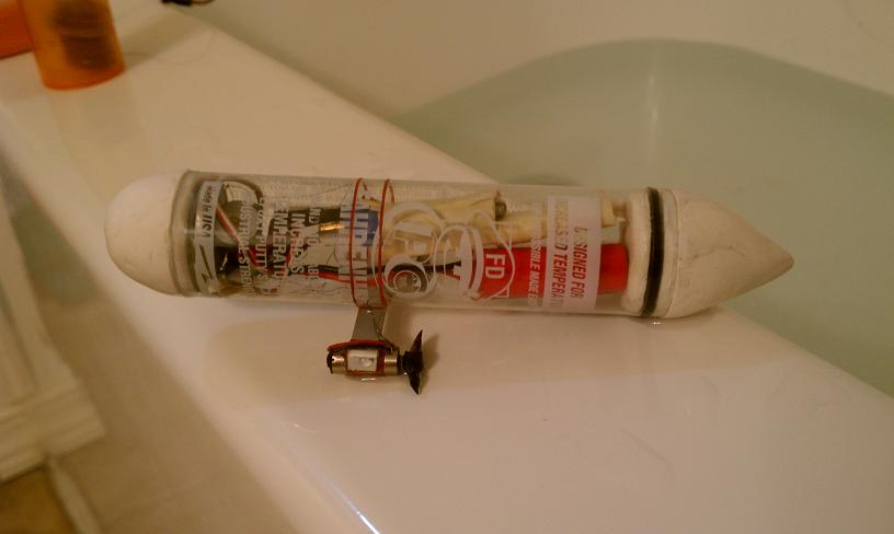

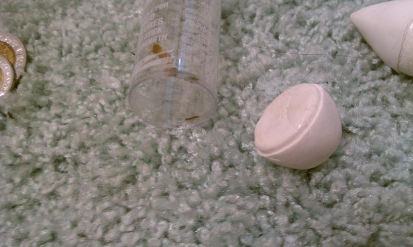

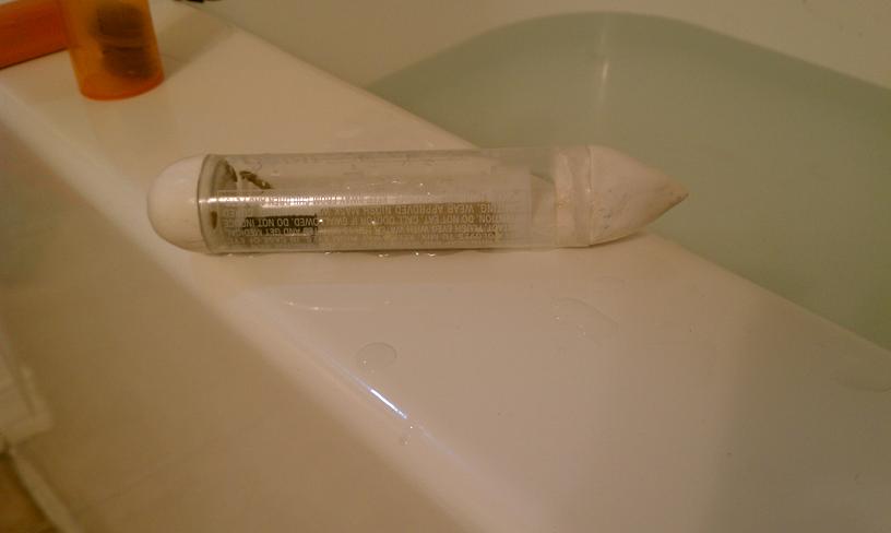

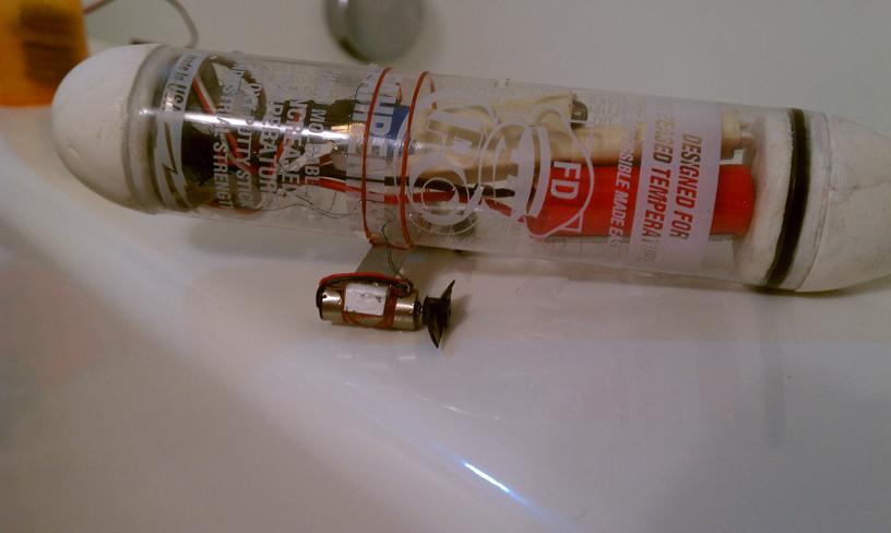

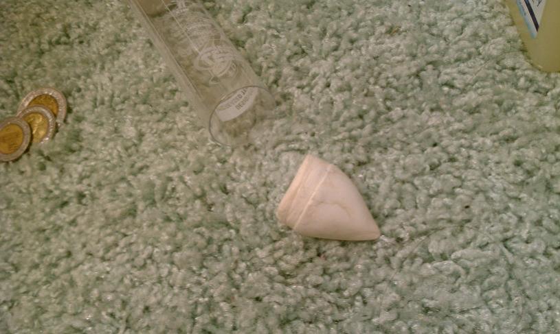

i am currently trying something i believe is a new material for making WTC end caps. its for a very small sub about 7" long and 1" diam. i molded some polymer clay into the end of the wtc which also shapes the rear cone, once baked, this stuff can be carved, sanded, painted so it seems a viable option. i will post some pictures once i have some more work done to it like the O-ring seat and some sanding.
