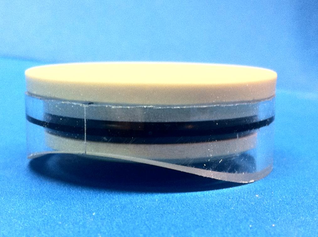

                        The top of my 3.5 cylinder features an extremely complicated ventilation system consisting of a section of 2" o.d. and endcap.
                        -Kerry
                          -Kerry
                          Interesting. How does it work?
                          • Slats
                            • 1776
                            Yes please tell us why, the great thing I find about the sub drivers are they are not complicated and I see no need for any extra ventilation / access.
                            Over the weekend during some testing of different motors, I was able to open up the cylinder, unassembled the motor tray, snort connectors, servo rods, aerial link, gear box housing, and removed the motor in 3 minutes. I then reinstalled another motor and all the gear and got running again in another 3 minutes. I don't think an engine out replacement of under 10 minutes is a hassle, in fact I think it is simply brilliant.
                            J
                            sigpic
                            • ADDINGTON
                              • Sep 2008
                              • 80
                              New build Cylinder for 80-inch DeBoer Seaview. Presumably it could function for quick air-out if desired between runs. Also, as the engine bulkhead is a wee tight, the top opening allows me to loosen the control rods at the servo and slide out the equipment tray which is connected to the forward bulkhead. Sorry to go off- topic a bit.
