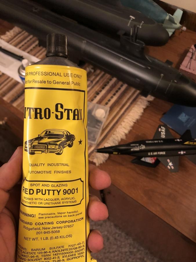

    Nitro Stan 9001
    My god. What have I become...

    Any tips for the uninitiated, from those in the know?
    As for the FOR PROFESSIONAL USE ONLY - is that like the warning not to cut the tag off my mattress? If they find out I am not a professional, can I expect a stern knock at the door? Black helicopters???

            Fantastic!
            Curious - how does it interact with polystyrene? Wondering about if the solvents in NS9001 might eat it alive or just bond really well to it. I am assuming it provides excellent adhesion to the base material and workability, otherwise you would not be using it.
            On the subject of solvents - I have seen you brush it on in a bunch of past pics. Do the brushes clean up with just Thinner or Acetone? MEK? Seems like it applies nice and thin, for a putty, then dries relatively fast. Interested about the syringe technique that you displayed. Does it need to be thinned down first?

              Originally posted by DMTNT
              Fantastic!
              Yes, the solvent in Nitro-Stan will eat into polystyrene and ABS and other chemically similar plastics. The polite term is, 'self-etching'. Use a little at a time and you're good. Use too much at first layer and you destroy the plastic.
              Cut Nitro-Stan with any Acetone/MEK heavy 'lacquer thinner' (some brands are good, some not so good).
              Here's the stuff I use to cut Nitro-Stan and clean my hand and air-brushes: https://www.woodcraft.com/products/k...5-e3fe2b272281

                Thank you for the wisdom, o' wise one.
