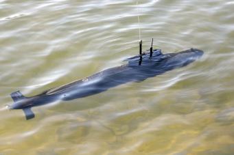

                That matte is the one I used to finish the Walrus. After sanding the krinkles from the black (being careful not to over sand it), the matte finish came out great.

                  Looks great-glad it worked out..Did you sand and refinish the affected area or did you spray over the spots and now they're gone?

                    That looks terrific! Nice save, sir.
                    Bob - I ended up spraying over the top of them with my airbrush. The soft edges and the leveling effect of the clearcoat made it a seamless fix.
