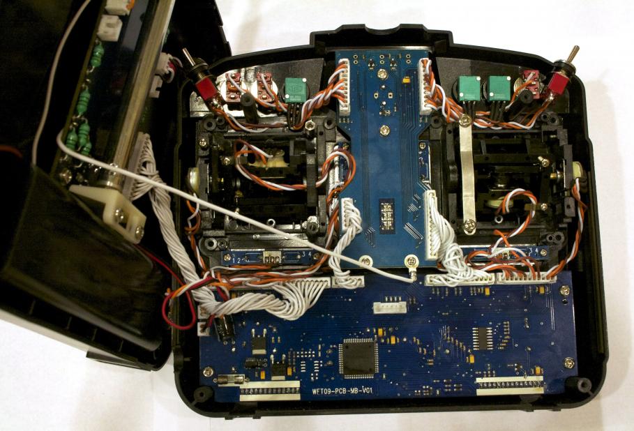

                              I got the O.K. to open up the TX.
                              Once opened up there were no immediate visible signs of a blown component. With computers, when a motherboard component goes bad, there are signs like a whitish powder or scorch mark from the failed piece. I did not see that nor did I smell the rancid smell.

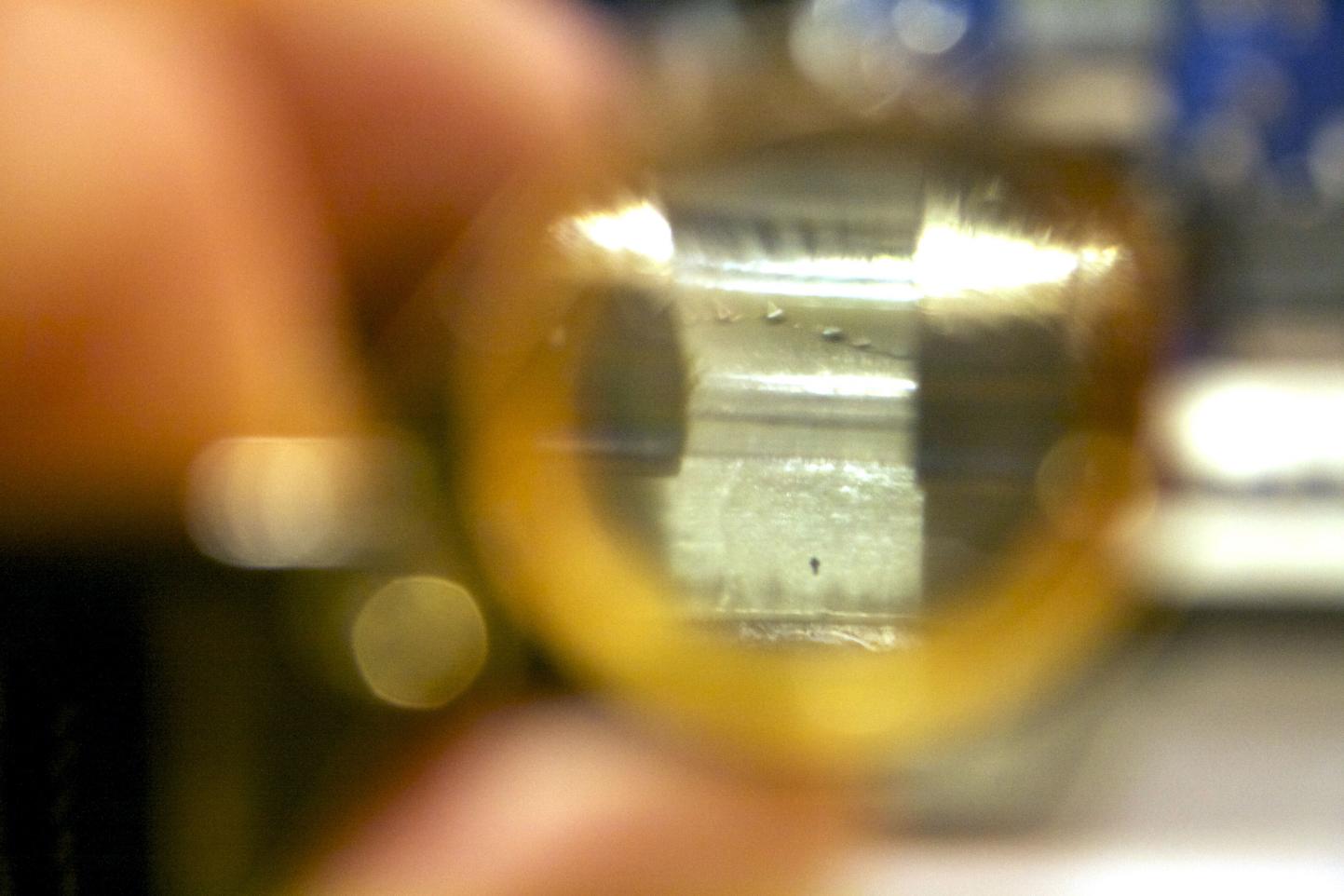

                              Followed the power from the battery compartment down. Cable was fine. Then at the lower left corner, I found the fuse. It was small so I grabbed a magnifying lens (Jewelers loupe) and looked at the fuse.
                              Please forgive the blurry picture, it was hard to hold the TX and loupe and focus in the light I have. You may be able to see it but 1/3 or so from the left side of the filament is a break. THE FUSE DID BLOW!!!!!! Why, not sure. I need to get a replacement fuse and see if there is any other damage or if the fuse will go again, at which point we have a bigger problem.
                              What are the specs on this fuse and I will order some. Since I am doing my own warranty diagnostics and repair, what is the going rate? I should not have to do this, but I am anxious to get my sub sea qualified and heck look at all the things I am learning! :-)
