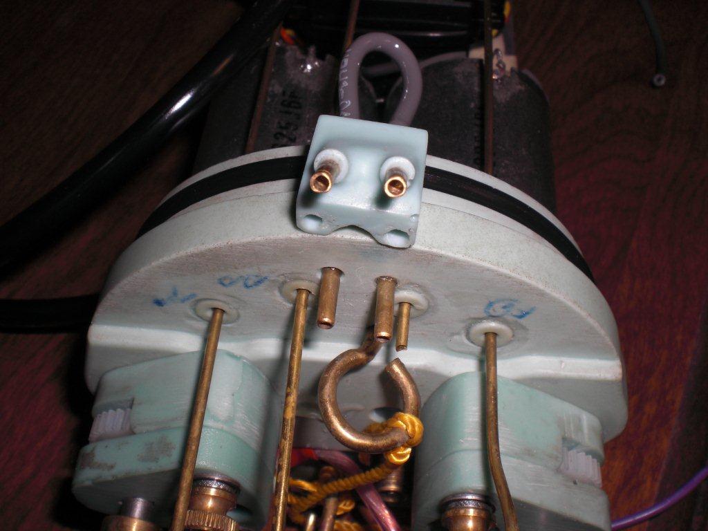

    I wrote you an earlier question on the snort system in which you answered but your answer made no sense since the kit did not have the tubing you specified. it came with a few feet of 1/4 tubing and I have the large snort system. I can see how everything should be hooked up but the tubing is too large to fit on the fittings except for the pump itself. I have sent pictures of my problem in an earlier post asking about help with the snort system and I have sent you a priveate message requesting information on how to connect this hose to the fittings but you have ignored it for almost a week as if your first message should have answered my problem which it doesn't. because your first answer was so off the mark with what is included with the kit I am a little worried about augering out the fitting to go over the nipples of the subdriver, I am afraid that it will make the fit way too loose or leak air to greatly to be able to pump out the tank or it might let the tank fill with water while the ballast valve is closed. and if I use clear silicone to seal it then the ability to remove the end cap easily goes away. see picture for how much I would have to drill the holes out in previous postings in the forum

            Forget the 1/4" hose -- that's the wrong stuff. Send me your home address via e-mail and I'll send you the 1/8" stuff. How many feet do you need?

              if you look at my picture of the snort manifold in the other post. does that manifold look like I could auger it out enough to fit over the subdriver nipples or do you think it will leak too much. What should I do to solve this problemClick image for larger version
