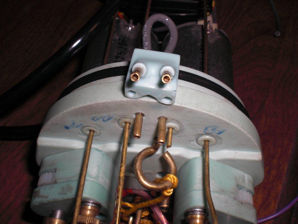

    Robert,
    Don't know about any 'black' tube, but it's the gray 1/16" i.d. flexible tube you make up to the 3/32" o.d. brass nipples. Use the same gray tube to make up to the LPB, you enlarge the bore of the flexible tube for those over-size LPB nipples by heating a 3/32" diameter wire to a moderate heat, inserting the wire into about 1/4" of hose, letting cool, then using the enlarged bore of the hose to tightly fit the big nipples of the LPB.
    Bore out the holes in the motor bulkhead manifold till it will slip over the two nipples.

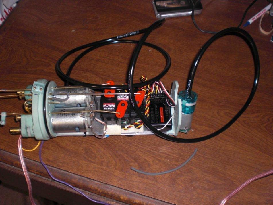

ID:	58824Click image for larger version
      as you can see I was given the large black tubing which is several feet long. the grey tubing I was given with the kit as you can see is only a few inches long. I original thought and still do that it is probably a replacement length for the blow tube in the ballast tank. I have no idea how I am to make the black tubing work since it only fits over the nipples of the pump itself but is too loose on the nipples. Just so I understand you though you don't want me to bore out the holes on the back of the subdriver but you want me to auger out the holes on separate two nipple piece sitting on top of the subdriver so that it can slip over the two nipples coming out of the bulkhead of the subdriver?
