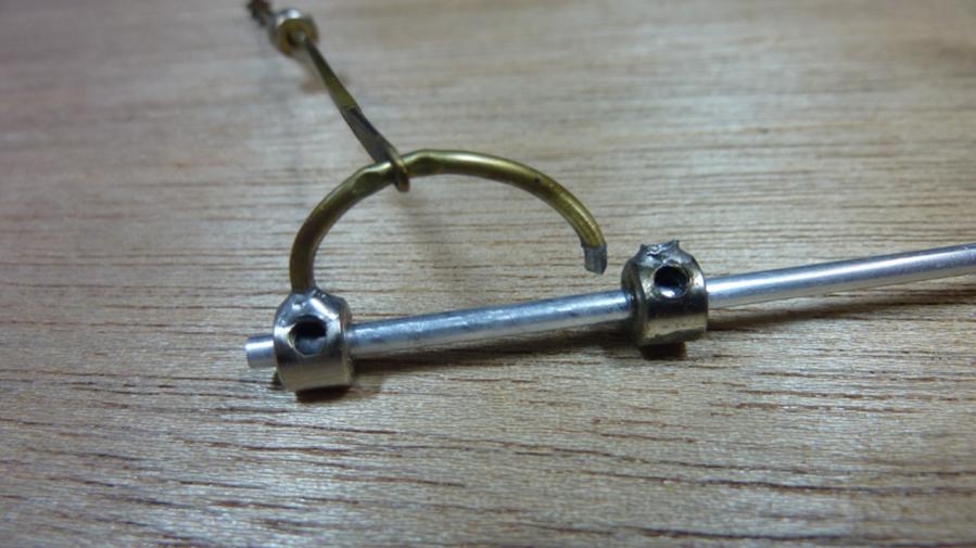

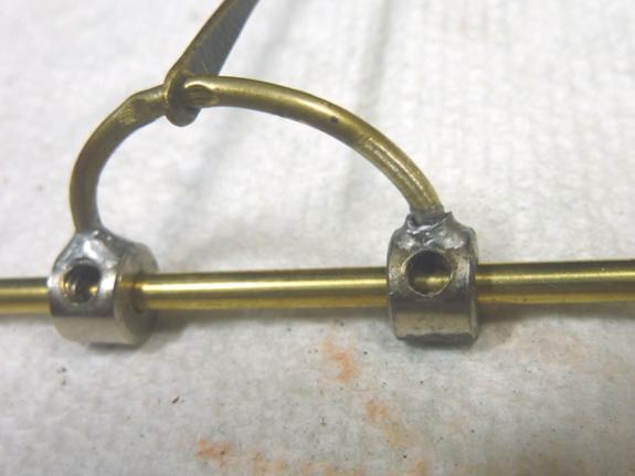

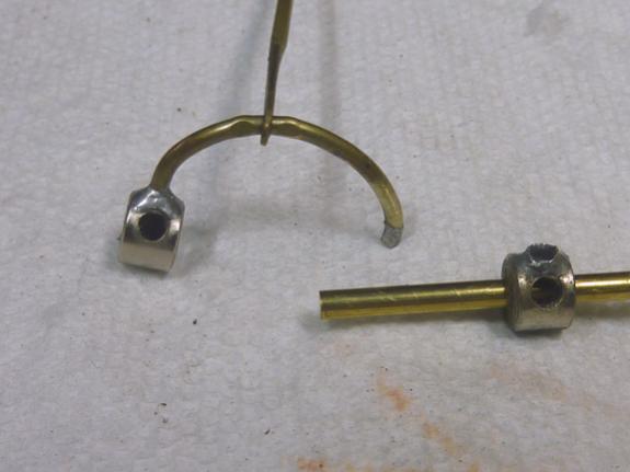

    I intend to solder the broken collar back on with ordinary Sn/Pb solder using a brass rod to keep alignment.
Name:	rudder yoke apart - small.jpg
ID:	100045...Click image for larger version
Name:	rudder yoke with brass rod for alignment - small.jpg
    Is this a reasonable method or should I just buy a new one from you? Perhaps you've improved the design.
    Dan
    • 14014
    Originally posted by roedj
    I recently purchased a third hand (at least) 1/96 Skipjack. There was some damage in shipping - hopefully I can fix it all. One of the things that got broken was the rudder yoke.
    [ATTACH=CONFIG]4188[/ATTACH]
    [ATTACH=CONFIG]4189[/ATTACH]...[ATTACH=CONFIG]4190[/ATTACH]
    Dan
    Dan,
    Your methodology is the same as mine, but for one big difference: I use an aluminum tube to hold the wheel-collars in position during the soldering operation. That way the solder won't stick to the mandrel as the union between wheel-collar and U-shaped yoke is made.
    Go get 'em, Tiger!

      Aluminum - good idea - thanks
      Dan

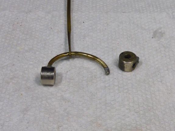

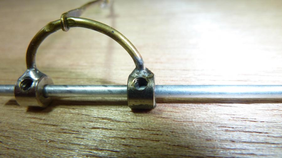

        the repaired yoke
        Below are the pix of the broken 1/96 D&E Skipjack rudder yoke before ...
Name:	yoke before.jpg
        and after...
Name:	yoke after.jpg
