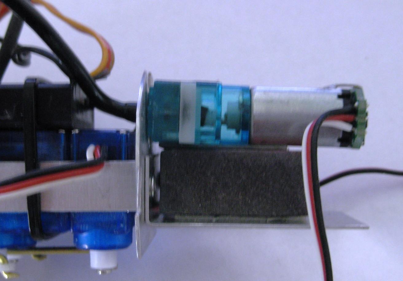

    With the MPC installed on the Snort Pump I found that there was a bit of interference with the end of the pump and the Ballast subsystem servo. I drilled two holes approx. 3/16" above the existing holes where the pump lines feed through (opposite side of the RX tray). This allows the pump face to be flush against the separator between the pump and the servo area and allows a much smoother run for the pump lines. See Pic.

    Good fix, Iran. Tight in there, isn't it?
