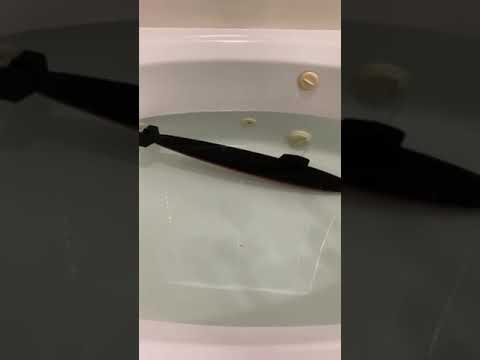

        Here is a short video of the first tests of the resurrected Skipjack sub. So far so good.

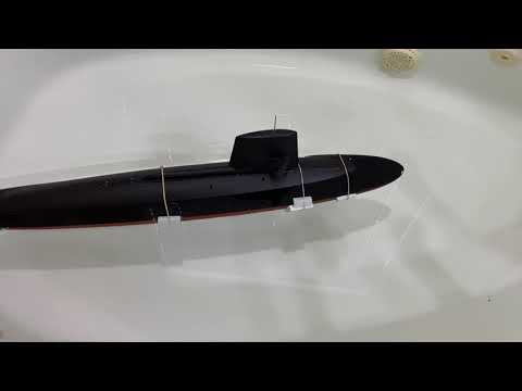

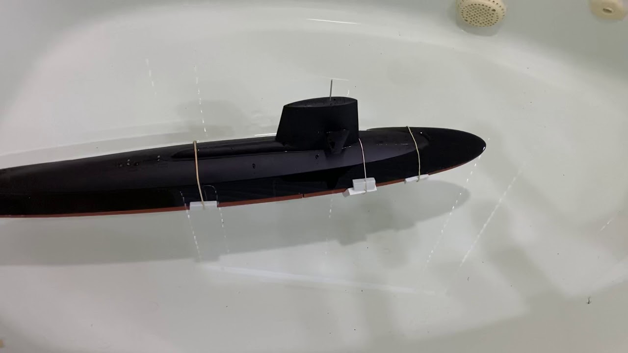

                  Here is my latest sea trial with foam attached with rubber bands. It has about 1/2” of the sail above the surface at full ballast. Now to figure out how to get all that foam inside the hull. There is not much room between the WTC and outer hull up front of the sail.
                    • 3769
                    Since this foam is for submerged trim, you will attach the foam high in the hull 9above water line). If your surface trim is fine with it, then you can put it below the surface of the water. Well done on trimming it!
