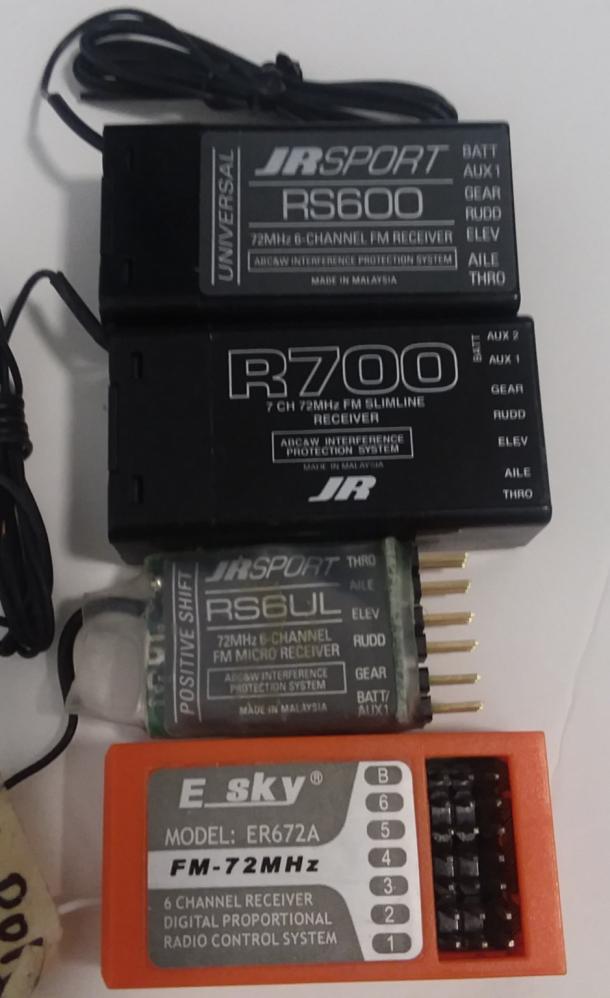

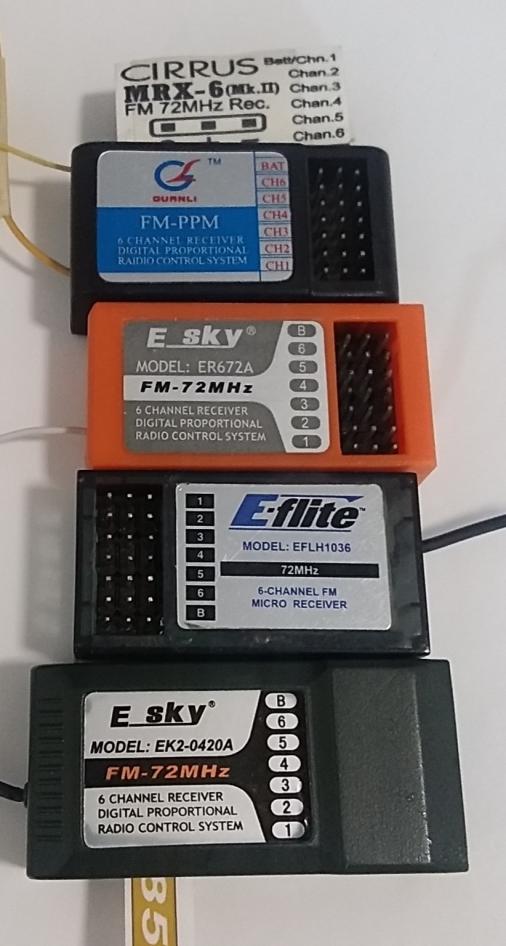

        Click image for larger version  Name:	20230108_072450.jpg Views:	0 Size:	60.1 KB ID:	168370 For what I know and tested.
        The RX crystal in the set is a single conversion crystal. So the Futaba FP-r127df will not works with the crystal, it's a dual conversion RX.
        all FM 75MHz and most (not all, short answer)72MHz negative shift will works with VEX / Futaba transmitter.
        As long as it has the matching frequency crystal, single or dual conversion.
        So all futaba, hitec(dual conversion) and some Chinese rx may works.
        Small good news, all brand dual conversion RX crystal are exchangeable. airtronics, futaba, hitec same!
        BUT not single conversion, hitec FM single RX use AM crystal!
        Bad news, (I am a half empty person)
        is very hard to find a matching frequency crystal.
        the rx crystal that came with the sets are single conversion.
        Single conversion receiver mostly comes in 3 ch mainly for cars.
        and the pins always pointed up, the wrong way.
        These are the receivers that works with the crystal that comes with the sets.
        l know they are all 72MHz, tested they work.

          Work around the long story.
          match up more RX crystal. ( Single or dual conversion )
          Make a TX crystal (futaba or compatible) adopter .
          replace the crystal socket on the TX.
          can't find any small RX that
          no soldering works around and all the pins pointed sideways, get a JR receiver!
          Is that JR RX is positive shift!
          I Tested it works.
          For reason I do not know. When you install a JR 75MHz crystal (matching frequency), it will turn it into a negative shift RX.
          note: on the "universal RX" set it to positive shift.
          Click image for larger version  Name:	20230108_080019.jpg Views:	0 Size:	56.4 KB ID:	168372
          [E-sky is for size reference]
          The Chinese one now is hard to find.
          But a lot of JR could find in used market, some time it came new in the box.
          The crystal is another story, good luck.
