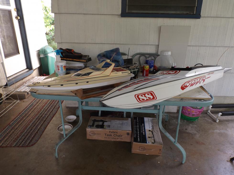

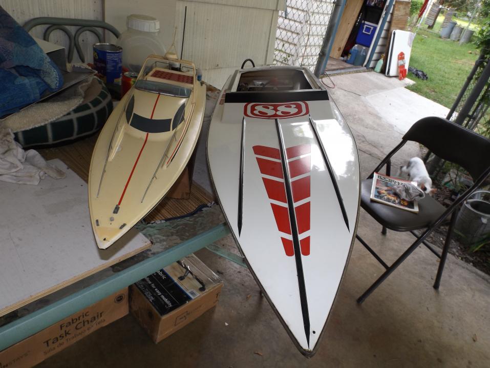

      Here is a view or two of the Graupner Portifino alongside an Aeromarine 50" Apache. These are the only Deep Vees that I have. My other Vee is much shallower in deadrise and freeboard. My mother agreed to hold it up for me. She didnt much approve of me posting these in the company of you blokes. She was especially wary of the one who has a Witch riding across the screen. We wont mention any names. At any rate I told her that you guys were OK.Click image for larger version

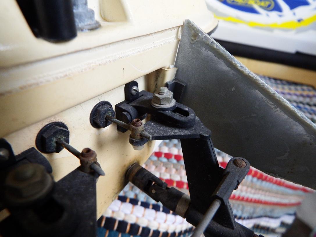

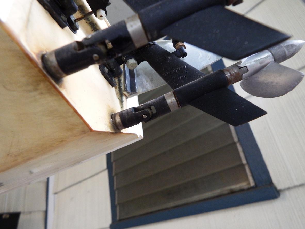

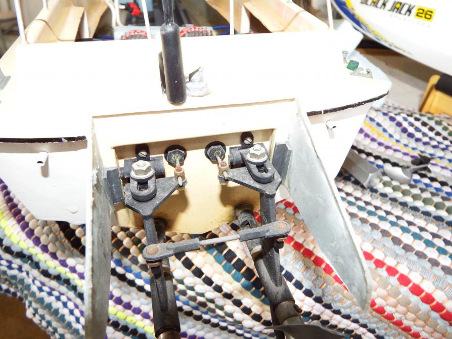

            In order to angle the props down a degree or two, I removed the prop cover to get a look at it. Using a straight edge,on the bottom of the hull, it shows that the prop drive line is running parallel to the bottom of the hull. So, I just loosen the large nut and bolt and angle it down and tighten it up. Oh, I cant forget about loosening up the pushrod adjustments first.Click image for larger version

              I got the drives trimmed down a bit, took it to the lake to try it. There was an improvement but not enough. Ill need some more down angle. I did try the two 2s lipos in series and there was a marked increase in performance. Ive decided that the speed control must be replaced. Something has happened to it over the years and its putting off too much interference thats affecting the range. Ill probably replace it with two 40 amp Mtronics waterproof jobs.

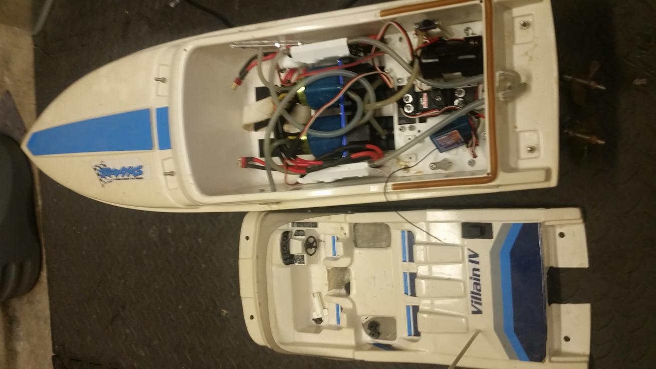

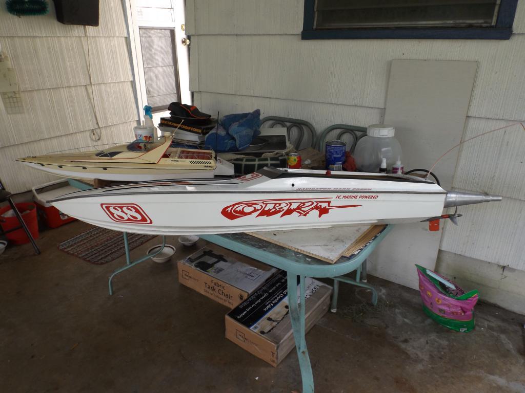

                      Photo of my once brushed Traxxas Villain, now in brushless. It's way too fast for the hull. This is probably very close in hull shape to the portifino. My dad's portifino has been converted to single prop brushless and is too fast for the hull to handle..
