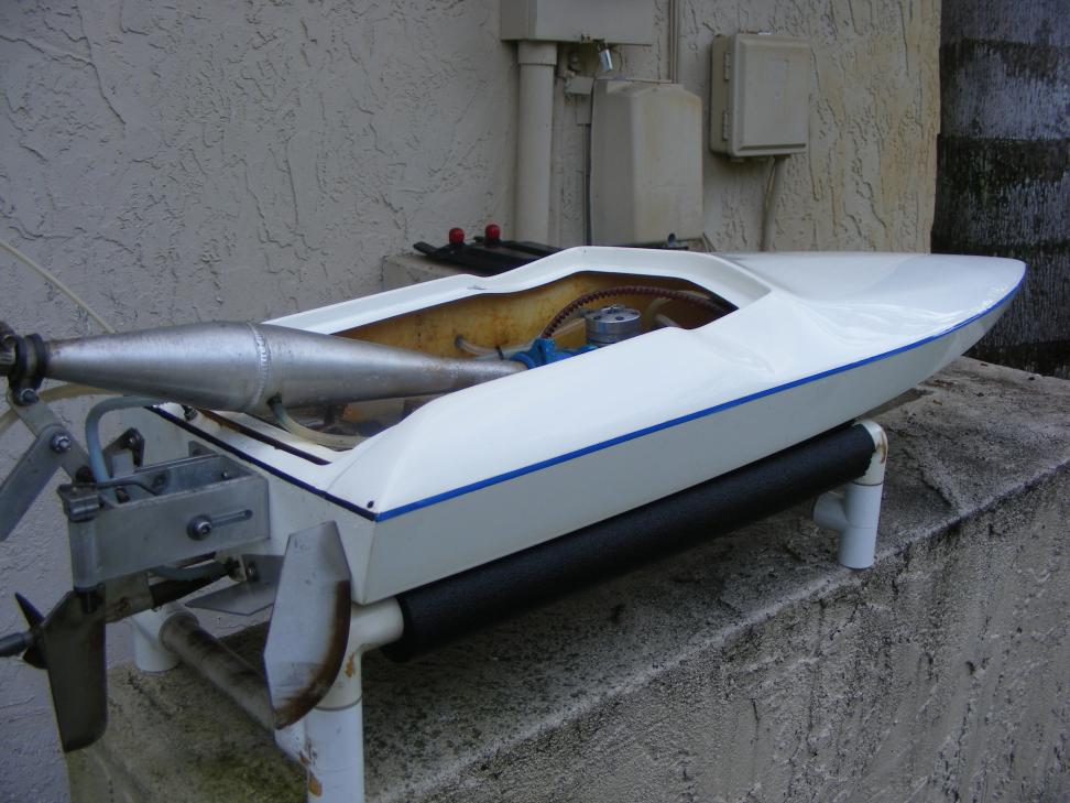

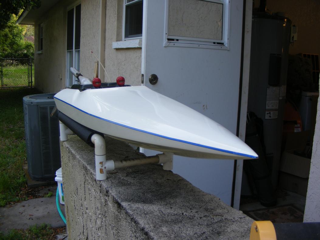

    This boat hull is made in Canada by A.C. model boats as a mono hull which is the traditional boat hull shape. Its proper name is the Wave Slave. In this case however it is of a shallow vee design which many believe is the fastest of the mono hull designs. This is the only boat that I own that I am actually afraid of. Afraid you say, why? Because the boat is sized and designed for a 3.5cc glow engine that produces somewhere around 1.25 to 1.5 H.P. Well I, on the other hand installed a 7.5cc engine producing around 3 H.P. It is a white knuckle ride all the way. It is a ballistic missle. In order to keepClick image for larger version
Name:	4-26-10 boats, oscar 030.jpg
ID:	99983 it on the water I had to angle the prop down 3 to 4 degrees and bend the trim tabs down and use twin turn fins and its Click image for larger version
Name:	4-26-10 boats, oscar 029.jpg
ID:	99982still a hand full. Why dont you take out that engine and put in a 3.5? Not on your life, its too much of an adreniline pump.Click image for larger version
Name:	4-26-10 boats, oscar 026.jpg

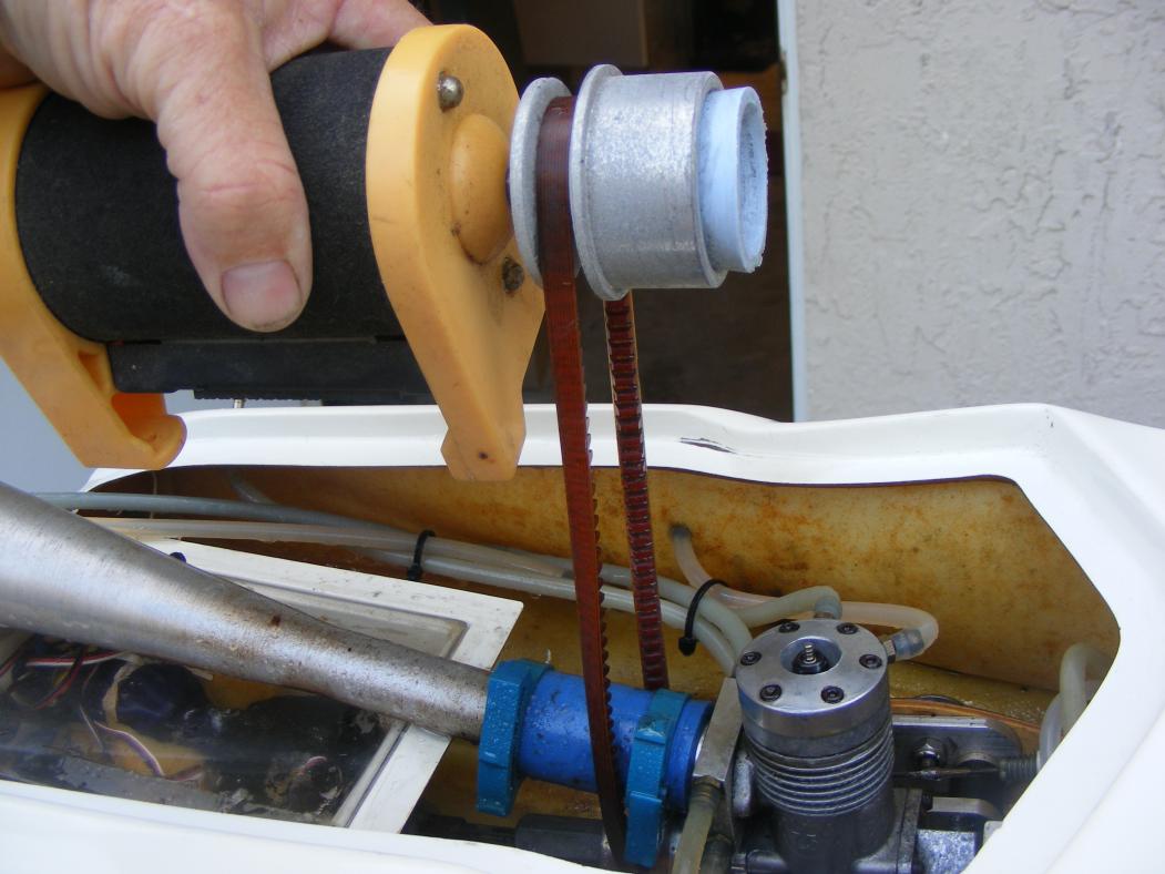

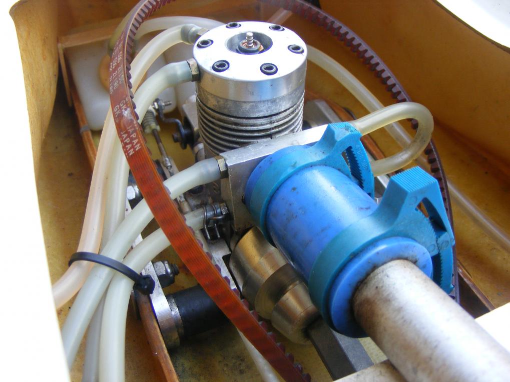

ID:	58544 Here you can see how you start it. There is a belt thatClick image for larger version
Name:	4-26-10 boats, oscar 024.jpg
ID:	58546 goes around the flywheel that stays with the boat.Click image for larger version

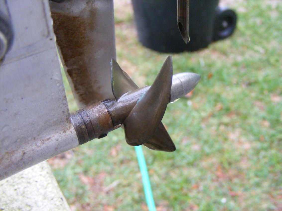

ID:	58545Here you can see the water cooling pickup set behind the propellor to pick up water sprayed by the prop.

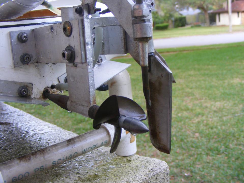

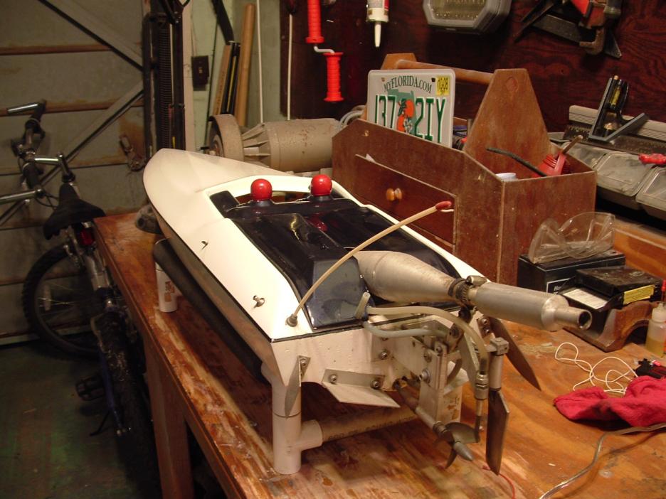

ID:	58638 Here are some better views of the business end of the craft. You have a large turn fin on the starboard side ,since all race boats in the US turn right, but it also has a small one on the left to help a little bit. The large trim tabs are a must when running this much power. They help to dampen out chine walking and to increase or decrease turning sensitivity. Also, and most importantly they help you control the boats attitude in the water by keeping the bow down. I incorperated a very novel water cooling system in this boat. That we will save for next time.

ID:	58657 You can see all of the stern hardware from here.Twin turn fins and the water pickup that gets its water from the prop spray.Click image for larger version

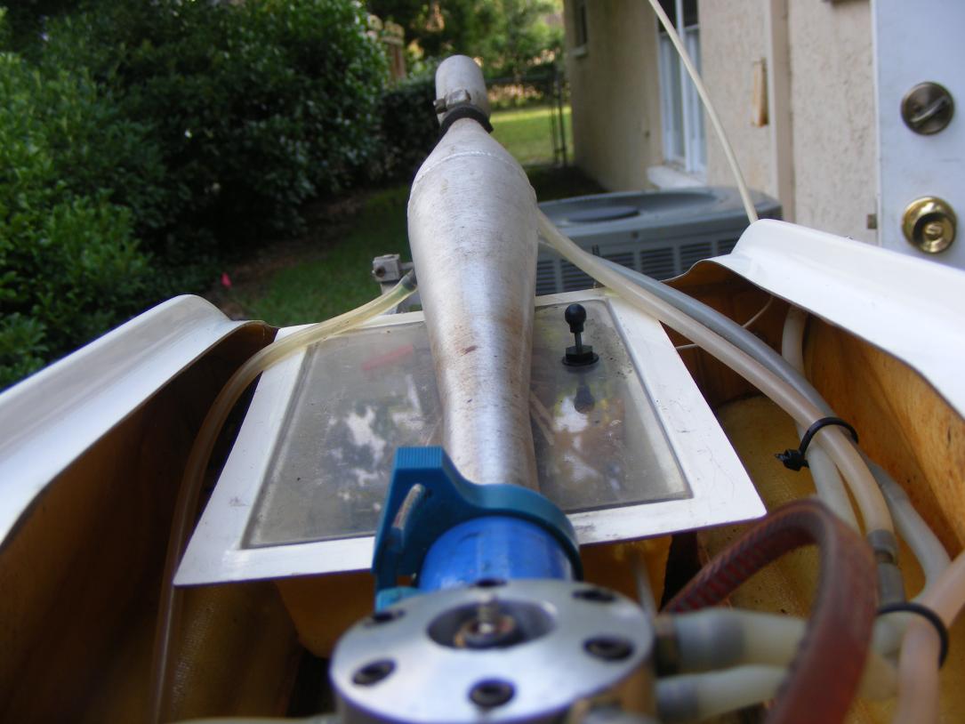

ID:	58659 From this shot you can see where it goes, The hose then attaches to a exhaust cooling header, right in the center of the picture and is then plumbed overboard.

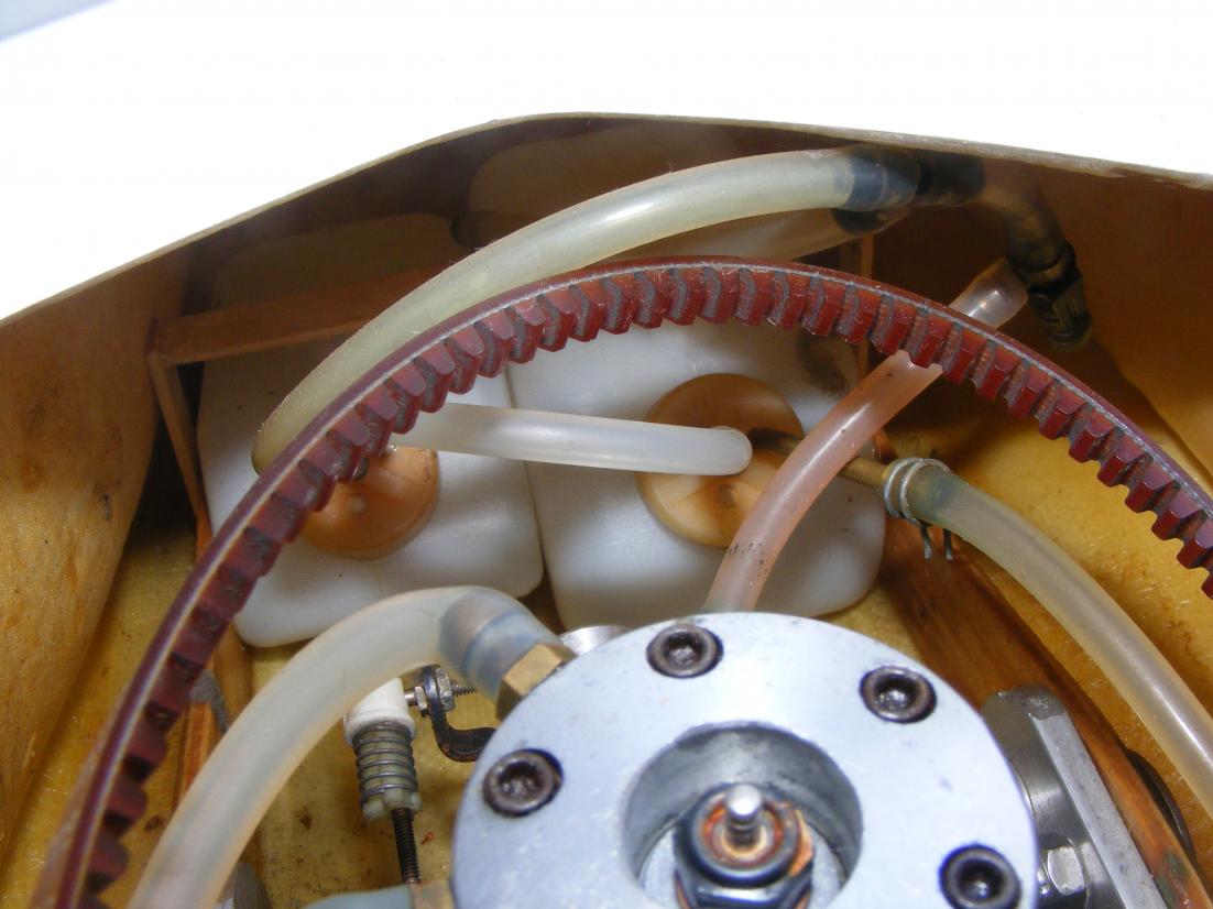

            The twin fuel tanks are easily seen here.
Name:	4-26-10 boats, oscar 071.jpg
            Also in view in this shot is the rubber isolating motor mount.
Name:	4-26-10 boats, oscar 072.jpg
