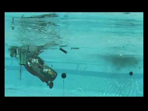

                  As a veteran of more than 30 scale ships - I have never used foam and never lost a boat. That said I have seen three Flowers go to the bottom all attributed to lake conditions. So do it on this smaller model.
                  J

                  • Reckless
                    • Jan 2012
                    • 183
                    that video always makes me sad :(
                    • Slats
                      • 1776
                      Don't be - the skipper fully anticipated its loss, although we were all dumb struck, including Pat Drake who set the mine field, as to the end effect.
