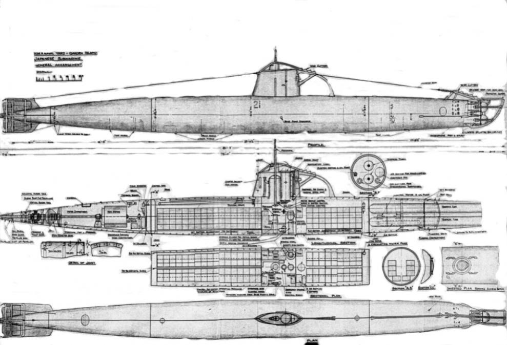

    My silly question is, "how do I make a hull for the sub I want to build?"
    The sub I would like to build is a Japanese 2 man sub in 1/16th scale, It will have a diamiterof 4" and a length of 54" tapering down to each end as per photo,
    How and what can I use to build this(the easy way) or where can I get one pre made.Click image for larger version
