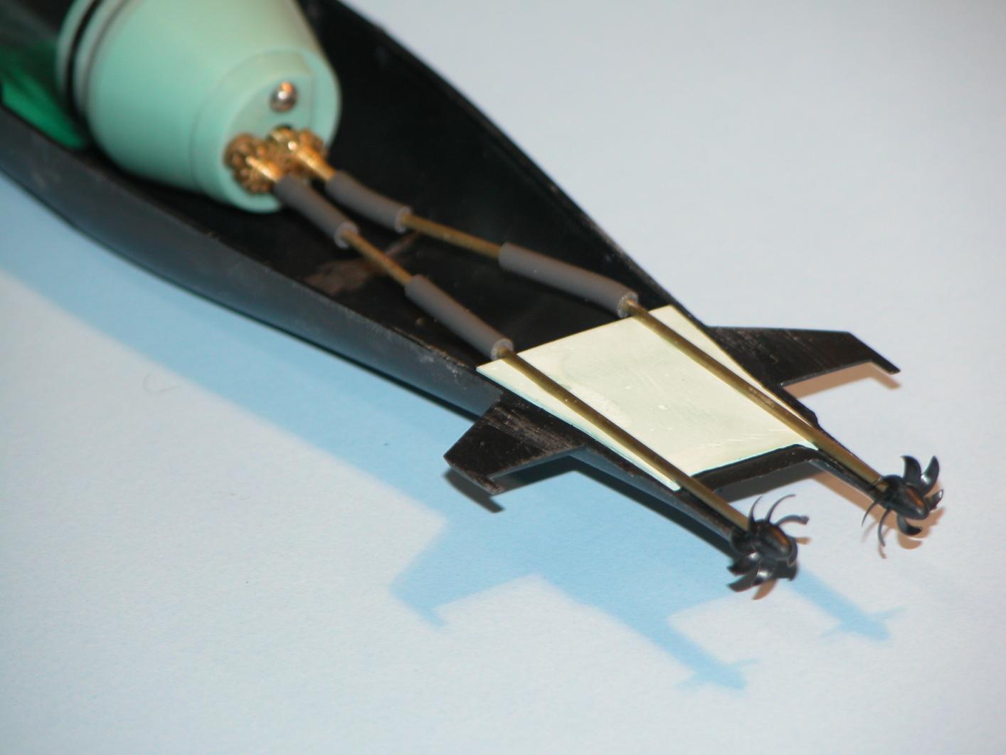

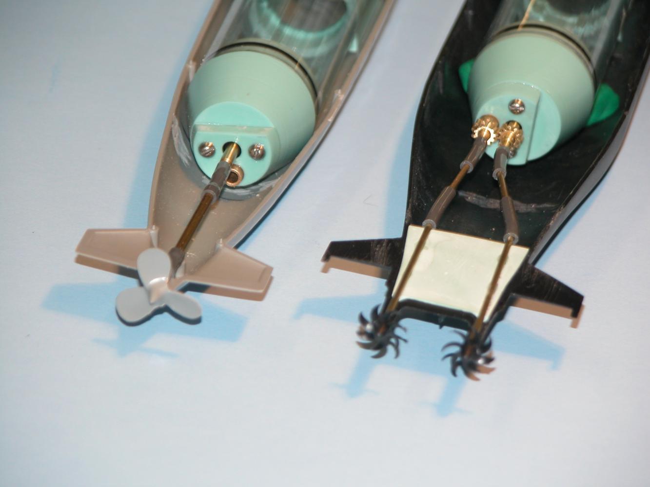

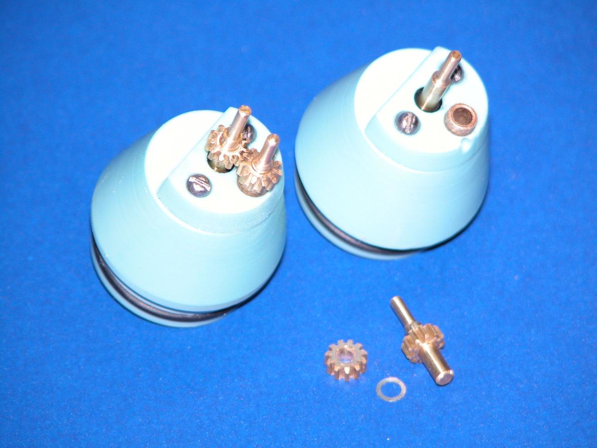

              Yeah, in the wet put a gear around the protruding shaft, and mesh an idler gear (same size) next to it. The shafts of these two counter-rotating gears drive the propellers.

                  Do it something like this:

                    Nice work!
                    Looks real sharp and simple too! I shall endevor (work hard) to make something like this. BTW, I was wondering about making the Marlin hull a two prop job since I have two 40mm counter rotating props lying arond and the Marlin is under the knife so to speak.
