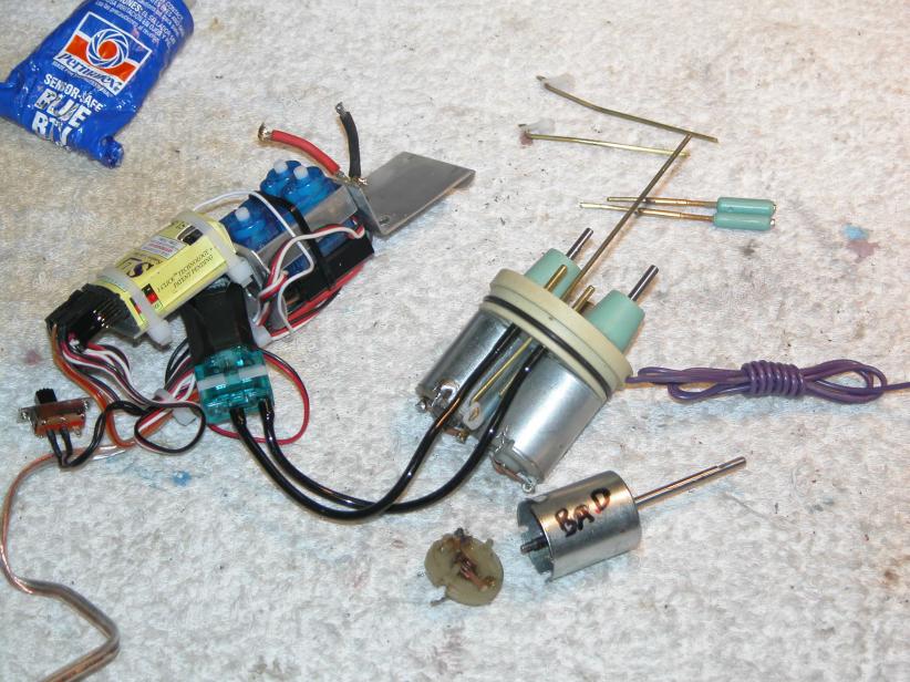

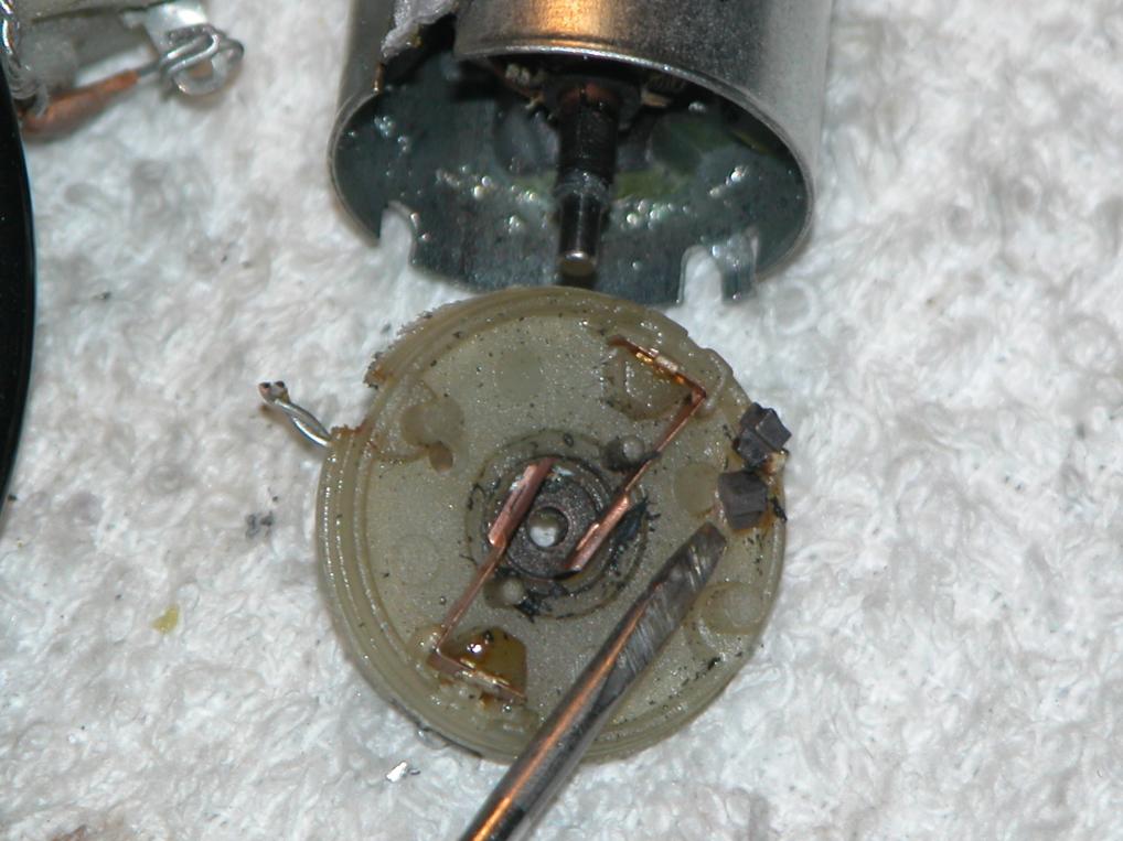

                  OK. The motor was replaced and I've enclosed two sets of LPB plumbing fixtures for you. You still need to leak-check the SD before committing it to use. And stick an ADF in there! Good device installation job, shows care and some cunning.
                  An autopsy on the bad motor revealed de-soldered field coil wires at the commutator -- evidence of an overheated motor. As you suggested, the motor was stalled during a run and over-heated. The resulting mess near the commutator got under the press-fit brushes and they flipped out of their tension arms, killing the motor for good. Lots of carbon build-up on the commutator pick-up points, likely the reason you had to push the motor to get it running sometimes -- poor electrical contact between brushes and commutator. Lots of arking-and-sparking going on in there till it gave up the ghost.
                  It's on it's way, this afternoon, overnight, USPS. I socked you $50 for the job.
