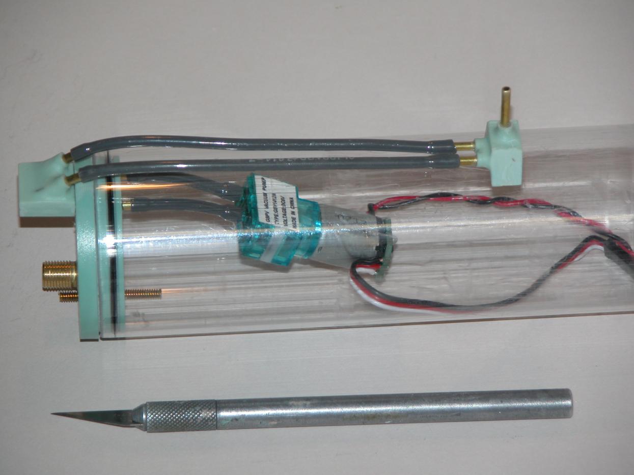

                I tried the 1/8" O.D. tubeing that was provided in my Seaview fittings kit on the small pump. It is a tight fit, but I was able to slip it completely over the nipples with ease, I just kept the tubeing in my hands and the heat softened it up a bit. So I will need not the nail trick to slip it on.
                Also, on the Seaview SD, you provide two 1/16" brass tubes for the snort ststem and that has the 1/8" O.D. tubeing on it formimg a loop. Is not the rest of the snort system useing 1/16" brass tubeing only?
                So, If I had a an O.D. 3/32" brass tube and put 3/32" I.D. plastic tubeing over it, would it not be too loose?
                The photos you provided here of the pump motor, is that 1/8" O.D. tubeing? Looks like it is, that's what I am going with.
                Dave, one more thing. When I said I was getting some of the 1/16" tubeing, I meant 1/8" O.D. tubeing.
                  Let's settle on common nomenclature: 'Tube' means stiff (3/32"od) brass tube. 'Hose' means flexible gray (1/16"id, 1/8"od) hose
                  You slipped HOSE over the two nipples on the LPB compressor.
                  There are no 1/16" brass tubes anywhere on my SD's. Just 3/32".
                  3/32"id hose slipped over 1/32"od tube is a sloppy fit.
