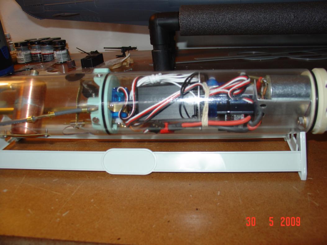

                        Just got the Sombra receiver today (6/8). It fits in the type VII S/D like it was made for it. Every thing is working great. I see why Caswell recommends the Sombra receiver. Much smaller. Now for the snort. It looks really tight but I do my best.
                        Jack

                          Well ... to be accurate: the space in the SD was designed for that neat little receiver.

                            You can tell at one look. It's packed in there like a sardine along with the snort but everything fits and works. A great receiver. Easy to set up with the little pluggy thing. The admiral here say's I can say 'little pluggy thing'. It's a "AFS Connector", goes in channel 8. It found the frequency right off. Not much further to go and it will be a submarine at last. The snort works great. Had no trouble with the black hose for the snort. Took 1/8 brass, tapered the end, heated it, slipped the end of the hose on the brass, waited to cool. Slipped it on the S/D and fitting for the Ballast tank. Made sure it was super tight. I'm a happy camper.
                            Caswell and D & E miniatures make super good stuff, Take a bow david.
                            Jack
