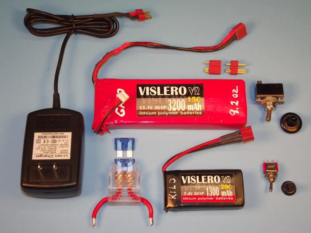

    I have a question regarding the charger sold on the sub driver website.
    The charger has a T type connector on it, usually reserved for power in/out connections only. The batteries sold on the website have the traditional white BALANCE connector (don't know the name) usually reserved for charging, as well as the T-connector for power out. Does this charger connect directly to the power out connector of the battery, ignoring the white balance charging connector??
    Thanks in advance...

    No need to balance charge our submarine batteries -- we're not competitive drivers. Don't sweat it. Charge through the two-pronged plug and you're gold, Kim.

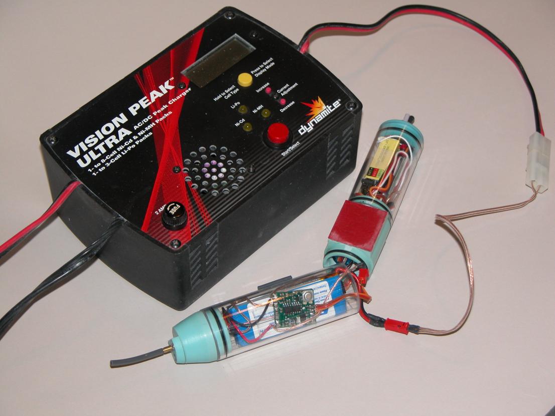

          I have no argument with Bart. He's absolutely right. But, my basic approach, though tough on the battery, and results a less than ideal cycle life, is good enough for us. I've got six-year old packs that I use on a regular bases that I've never balanced. I'm sure if we analyzed them we would find a significantly reduced capacity from factory fresh because of the differential voltages between the cells.
          I'm the pragmatic sort -- good enough is less aggravating than the expense and effort required to approach perfection.
