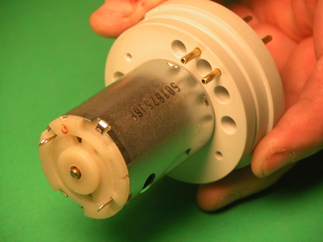

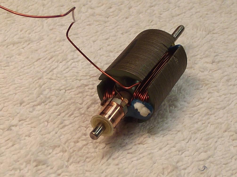

      Try this on for size:
ID:	93138 Click image for larger version
ID:	93140 Go for the 550. Whatever flavor you like. These are five-pole motors, with only 25 turns per pole. Hot! And el Cheapo! And they come already spark-supressed.

          Nope. The 550 designator only tells you the armature diameter, number of poles and case length. Tells you nothing about how many turns. You have no idea from the '550' what the rated voltage is or the number of turns per pole.
          The 550 we offer is rated for 12-volts and is pretty hot at 25-turns per pole. Can't speak for the 'other' 550's out there in motor land.
          Guess how I worked out the turn-count on our motors? ...
          • Scott T
