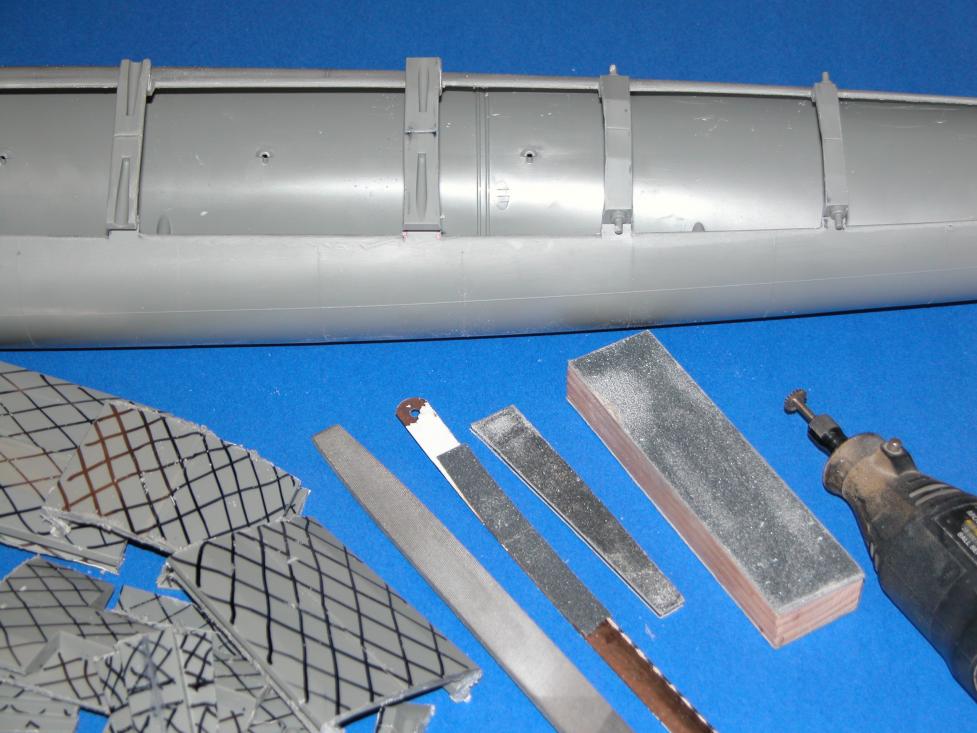

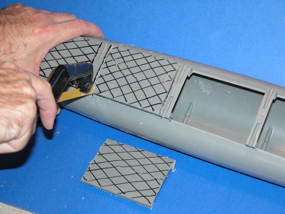

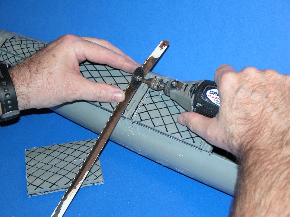

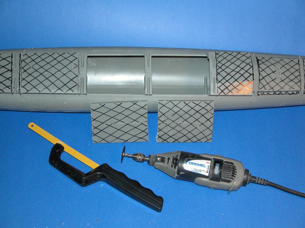

    Im starting to build my 1/72 gato and need a little advice, hahaha. Anyway I decided to drill out all the vent holes on the deck, but my drill started to melt the plastic and probably should have stopped there, but I didnt. I then bought a set called BIG RED that includes a lot of PE, expecially all of the decking. So I follow the directions and it says to remove the decking in whole pieces of it to replcae with the PE decks provided in the set. I did use my dremel with a thin disc to cut out the plastic, but again and I knew would happen, it started and did melt the plastic. My question is what is the best way to cut out plastic on this kit without doing more damage to the area you dont want to melt?
    Do it slooooowly.
      • 14010

      and use new, virgin, sharp, rotory saws .... not that nasty one at the bottom of the drawer that was used for glass work last week!
