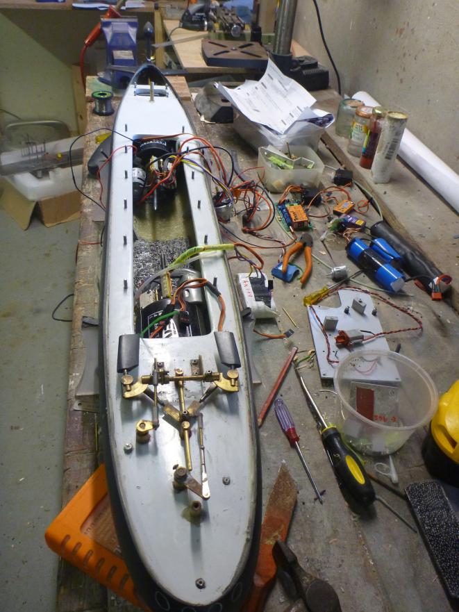

          Thank you kindly. Heading down to the bunker to give it a go. Attached is a picture of the mad professor's workshop. Clutter? What clutter. Click image for larger version

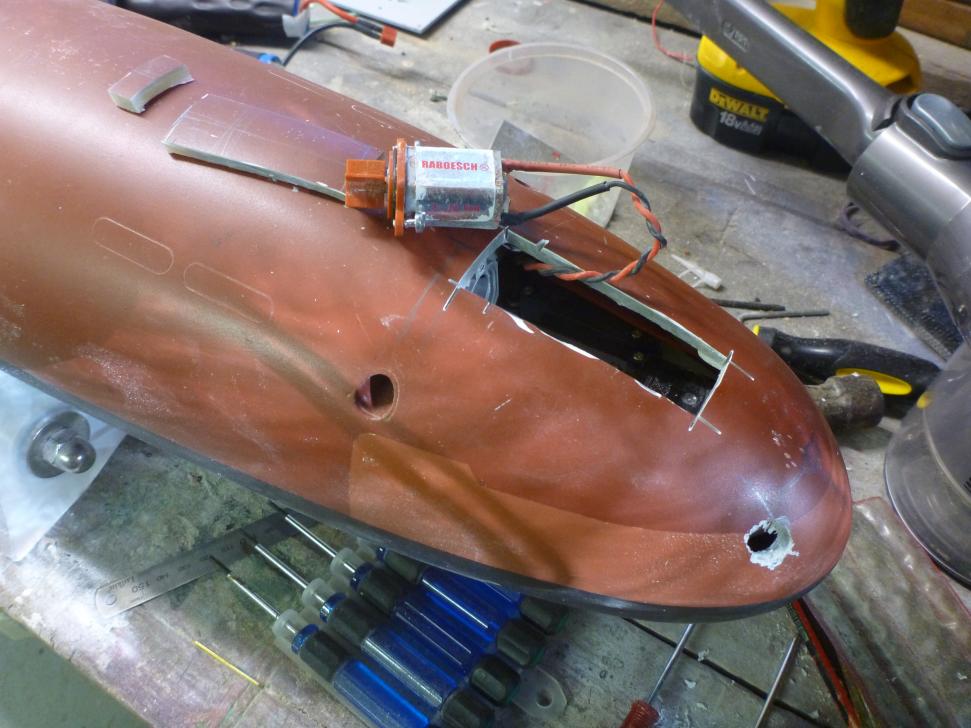

                            All good. It worked by the way. Now to fix the pesky bow thruster. What happens when a good bow thruster goes bad? Well, this happens.
                              OK. I now have power but there is a new (and interesting) glitch. The TMax control system on this boat allows the tanks to be full empty, 90% full and 100% full. empty and full are working just fine however at 90% the bow tank glitches back and forth as though its hunting for a position. I've fitted suppressors allover the boat; the thing has more rings than an analogue telephone, but the glitch persists. Any ideas would be most welcome.
