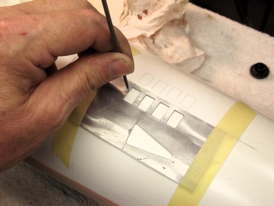

    What special problems does gel-coating, if any, create when scribing a gel-coated hull? Will the gel-coat easily chip - making scribing difficult and are there special techniques that might be used with gel-coat? Thank you.
    • 13980
    Gel-coat, when applied correctly before the GRP layup process, bonds very tightly to the underlying glass laminates. But, DeBoer hulls had a big problem a few decades ago with some product that evidenced an easily chipped gel-coat revealed during machining or scribing of a GRP surface; a problem later fixed. However, there are likely still hulls out there with this issue.
    Otherwise a reasonably thick gel-coat is the ideal substrate into which one would engrave lines with a scratch-awl.
