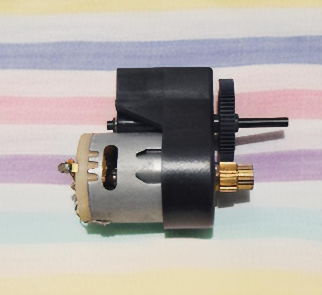

Can I use this in the Type XXIII
    • 3664
    Found this inside the Bonco box together with kit.
    Click image for larger version  Name:	20260728_082807.jpg Views:	0 Size:	50.9 KB ID:	196715 Brushed 380ish motor with gearbox, 66T spur 22T pinion 3:1 ratio.
    • 2612
    Might load up a bit for a 2” diameter prop. 4:1 would be a better ration for a 400 size motor.
      • 918
      Can't you just test, and see? Add to a shaft with the 2" propellor you plan to use with end of the shaft in water, use a Voltmeter to measure draw on battery. Looks fine to me but get some data.
