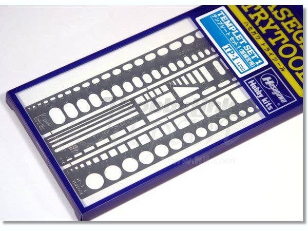

    Sewing needle chucked in pin vise and a scribing template. Click image for larger version

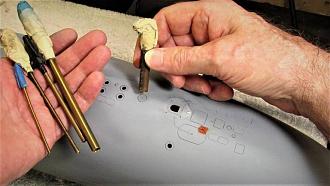

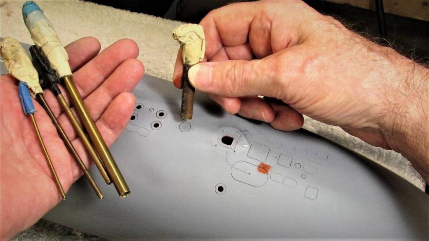

            I like those improvised brass tubing hole saws.
            Get the approriate size tubing. Rough up the edges then twist and twirl. Click image for larger version

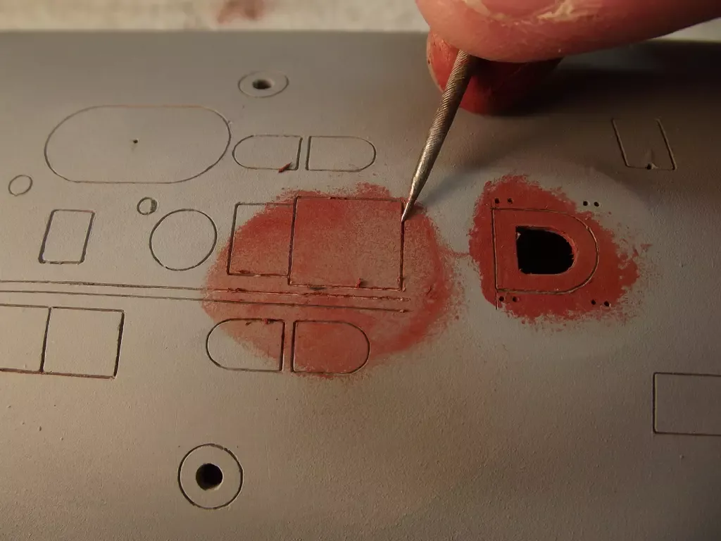

ID:	194640 David - what is the purpose of the filler in this photo? Has it been applied AFTER scribing to help clean up edges? Was it applied BEFORE as an aid to scribing? I don’t understand. Thank you (as always).
              Tim
                • 13984
                Click image for larger version  Name:	IMG_7467.webp Views:	0 Size:	46.4 KB ID:	194640 David - what is the purpose of the filler in this photo? Has it been applied AFTER scribing to help clean up edges? Was it applied BEFORE as an aid to scribing? I don’t understand. Thank you (as always).
                Tim
                Initial scribing, with a stencil guiding the engraving tool (scribing is not a one-step process), there will result the inevitable over-strikes and miss-moves of the scribing point into the work. Even with such boo-boos you proceed till the correct outline has been engraved into the work. You then press filler/putty into the engraved work and, before the filler/putty hardens, you chase out the filler/putty -- without aid of stencil -- from those engraved lines you wish to retain. Sand, prime, and repeat as needed.
