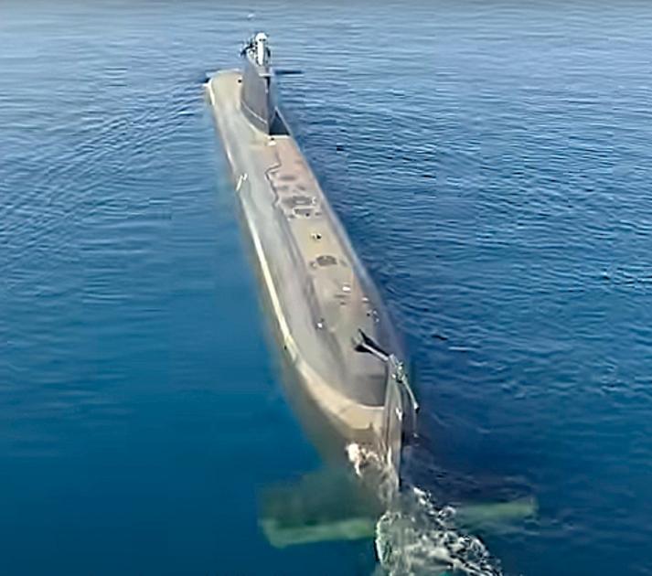

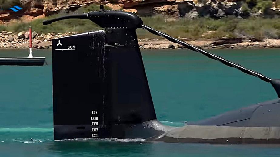

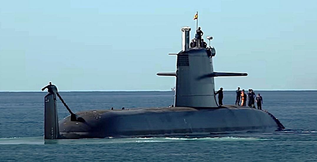

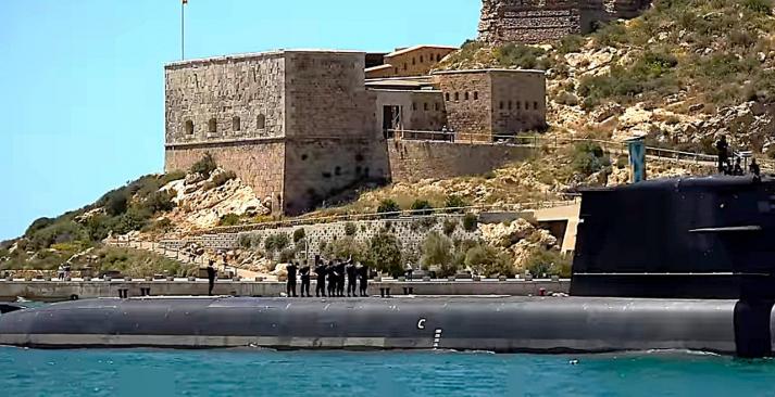

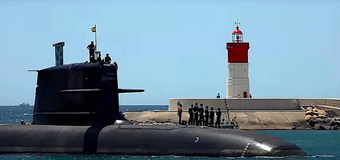

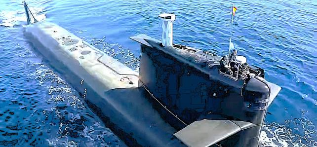

    This You tube video as some great images and close up details in places. Enjoy.
    Stills:
