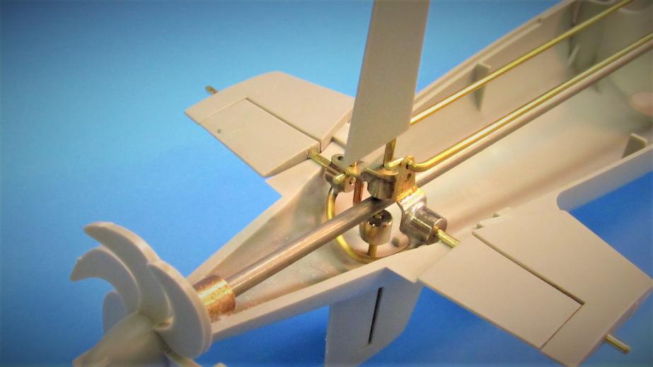

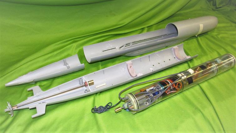

    If the propeller shaft extends any considerable length from the stern tube -- typically running through a strut bearing just forward of the propellers hub... hanging out there for God and everyone else to see -- then shaft diameter is driven by the models scale. In such situations I'll go from 1/16" to 3/16" diameter, depending on subject.
    If the propeller shaft does not extend outside of the hull (modern 'teardrop' hulls) I prefer 3/16". Not for strength -- always go with stainless steel -- but for convenience.
    Here's how I handle a 1/96 LA boat and a 1/35 Type-23, both big enough to house the bigger diameter shaft:
    3/16" propeller shafts.

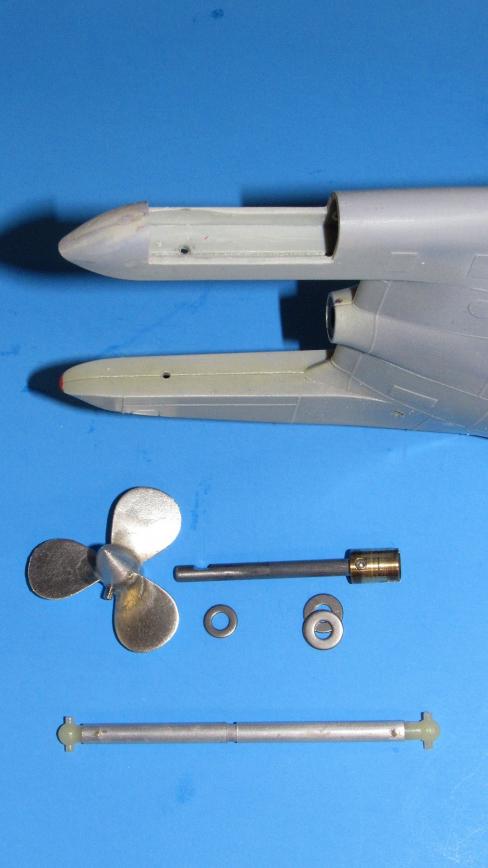

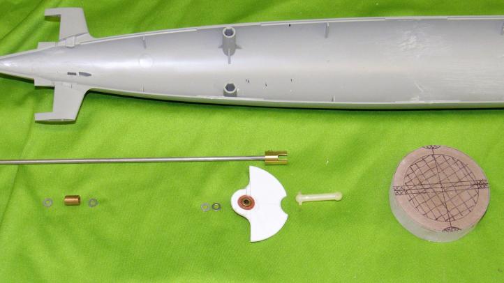

    And here is the 1/144 XIA SSBN that uses a 1/8" propeller shafts due to its small size and tight tappered stern:
