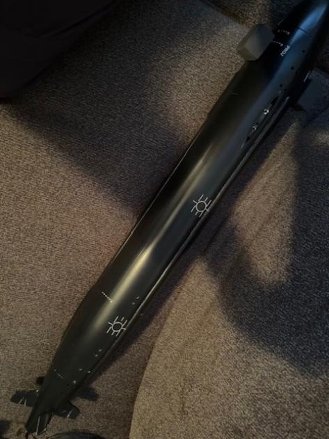

    I have purchased a 1/144 Seawolf, used. The parcel delivery was unkind to the process, damaging the WTC. I have a new polycarbonate tube, but need to cut it to replace the 8.5x2.5" section. First dumb question: Hacksaws? Coping saw? Cut off wheel from a dremel then sand?
    The model is complete. Probably needs some repainting, though seeing it in the water in Georgia would be nice. It also has fixed bow planes. I suspect getting those going would be foolish? Better off with a different model if that is what I want? (The WTC would need another penetration and seal, and the linkages, etc). Also has a prop, not a pump jet. Really, it is my first boat, so if it isn't perfect, it's fine.

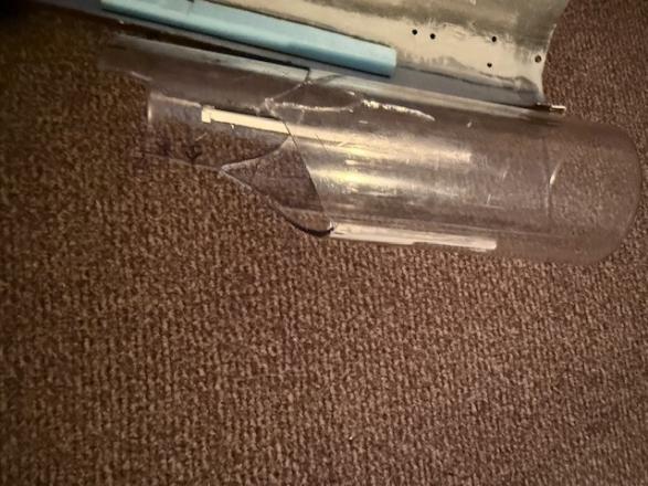

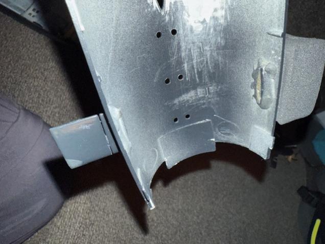

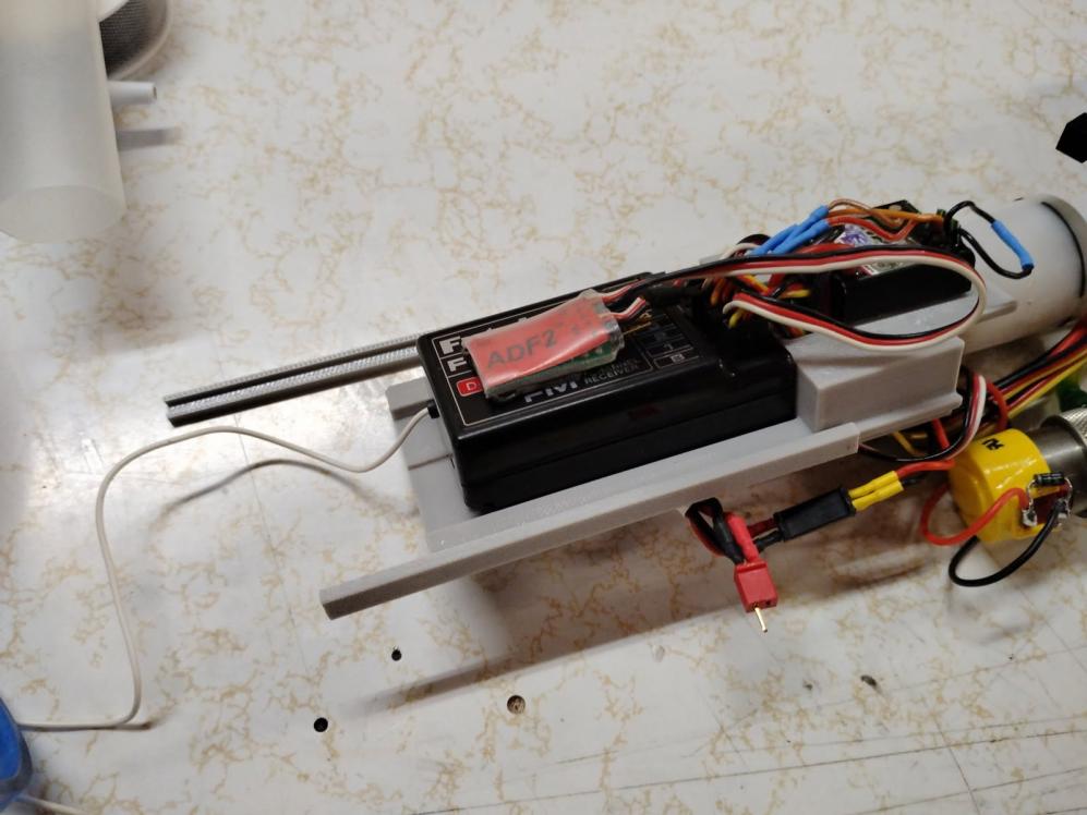

              So, the original part of the cylinder was crushed. It contained two rails glued in place to allow a tray to fix items in place. For replacing the tray, is there a suggested method of gluing the rails in place? It feels like a potential mess.
              Thanks!

                Pictures would help us formulate the least painful fix.

                  Your WTC is a RCABS cylinder based off the design of Rogue SubWorks.
                  The electronics tray slides in and out of the WTC on 2 C-rails glued to the inside of the cylinder.
                  Technique to how to glue in rails can be found here Rogue Sub Works diy-rcab (2) (resized) (pdfresizer.com).pdf

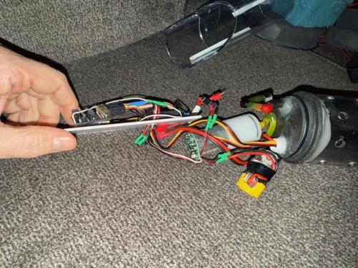

                    oh, thanks! and pics:Click image for larger version

                      OK, you need to secure a new piece of 'U' section ABS. It's available from PlastStruct. Adhere it within the cylinder with RTV 'gasket maker. Make sure you de-grease the interior of the cylinder before glueing.
                      I think this is the product you're looking for but check the dimensions to assure symmetry with the 'good' rail-guide already within the cylinder. There are a wide selection of shapes and sizes, so take care before ordering.
                      Amazon.com: Plastruct UFS-8 Deep Channel1/4 5 PLS90585 Plastic Building Supplies : Tools & Home Improvement

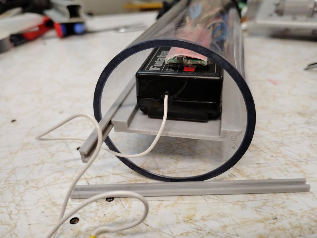

                        I may have missed something but the rails and chassis look 3D printed, regardless, again, follow Dave's advice. I've used RTV gasket maker before but it has not occurred to me to use it for an application like this. Good stuff!

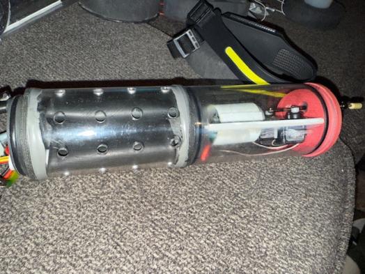

                          I feel I should follow up. A good friend has been instrumental in helping and designed the new 3d printed chassis since I initially asked, inadvertently making me a fibber. Ultimately we went with RTV and it worked well. Thanks All!
