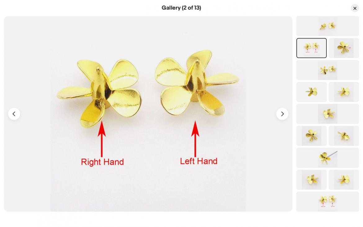

    Dual Prop Install
    Does it matter which side (Port vs Starboard) I install my RH & LH Click image for larger version  Name:	Image 2-10-25 at 5.16 PM.jpg Views:	0 Size:	44.0 KB ID:	185956 props? Are there any characteristics created by which side they are installed?

    Yes. Looking forward: clockwise ahead -- starboard side, counter-clockwise ahead-- port side. Most submarines and ships with a single propeller, clockwise (but most modern Ruske submarines are counter-clockwise)
      Thankyou Sir! So RH goes to Starboard side?
        Yup.....................
