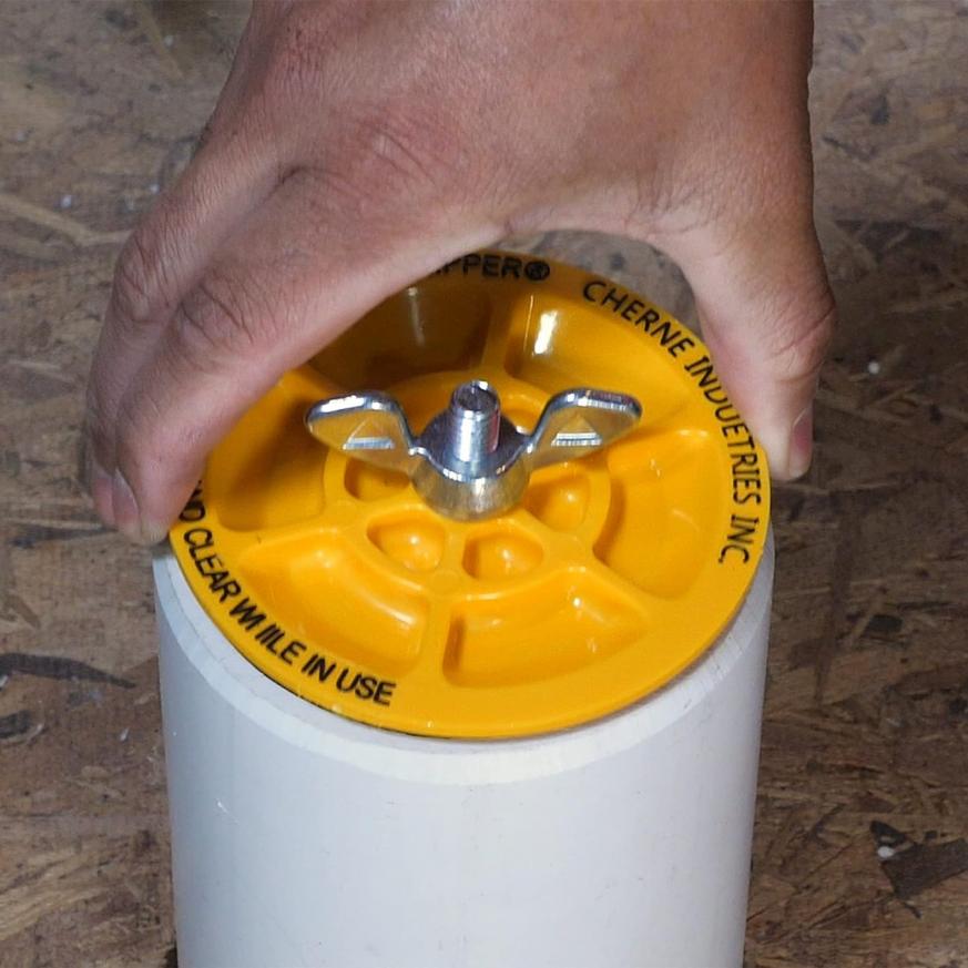

          • 1999
          There are standard pipe plugs that you can get for endcaps. The center of them is a massive bolt, but you can offset your driveshaft and linkages. Would save machining endcaps. and then it really would be able to be driven over!
          Link to product on Amazon
