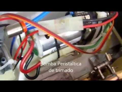

        1/10 Icteneo model with Stuart Twin steam engine running on compressed CO2
