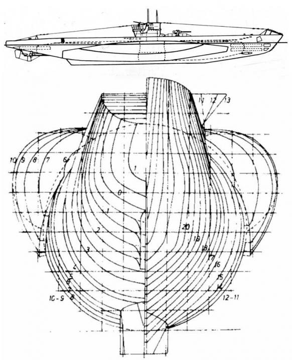

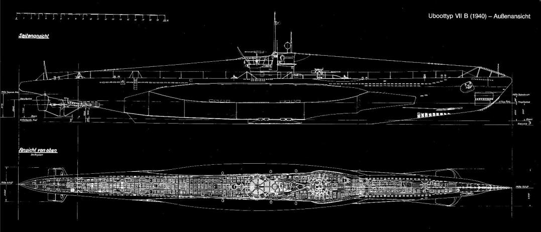

    Anyone knows the VIIB plans below? I don't know the original source of the cross sections of the VIIB, but the numbers of the sections seem not to match the side view & top view...

    The side view of the first set of plans is inaccurate, the shape of the saddle tanks is incorrect. I think those plans are from the Rossler book which simplified a lot of the U-boat side profile views.
    The second set of plans in black is more accurate.
