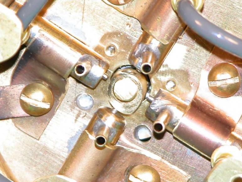

    Can anyone tell me the structure of this little firing valve? I'm curious how it releases the gas, and a sketch of the structure would be nice.

    Those are four poppet valves surrounding a cam-as the cam is rotated (by a servo) each valve is depressed one at a time to release the gas-click here: https://engineerscommunity.com/t/bal...principle/6098
      • 13990
      Bingo! Thanks, Bob.

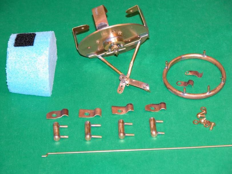

      Here's another version of that type valve:
      And a better look at those little firing-valves.
