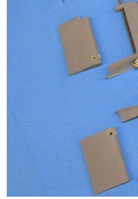

    To secure the Rods to the Planes what drill size, tap size and grub screw do you guys use? Click image for larger version
    • 13973
    3/32" bitt.
    4-40 bottoming tap.
    4-40 X 1/8" set screws.
