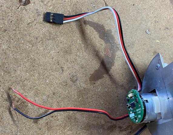

                          Next question. Where does the bare wire coming out of the pump Click image for larger version

ID:	146883 connect? I figure the plug goes into the RX.
                            Thank you
                            Red and black wired in parallel with the main battery cable -- observe polarity or things will go terribly, horribly wrong! The servo lead goes to the output side of your fail-safe/BLM/LipoGuard/Flux Capacitor/Whatever as one leg of a Y-lead. The other leg goes to the ballast sub-system servo.
                            • secrtwpn
                              • Feb 2012
                              • 182
                              Got it! Thanks again
