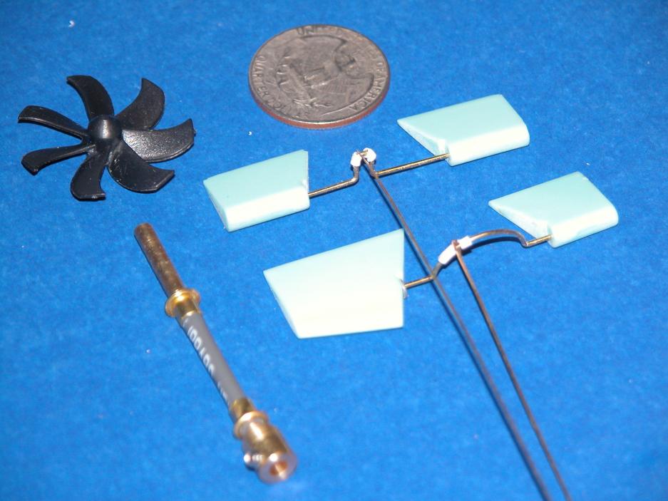

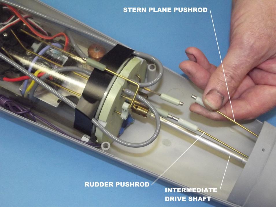

    The good old Dumas 'dog-bone' link and two couplers. Quick connect/disconnect and is a near perfect universal joint as well.

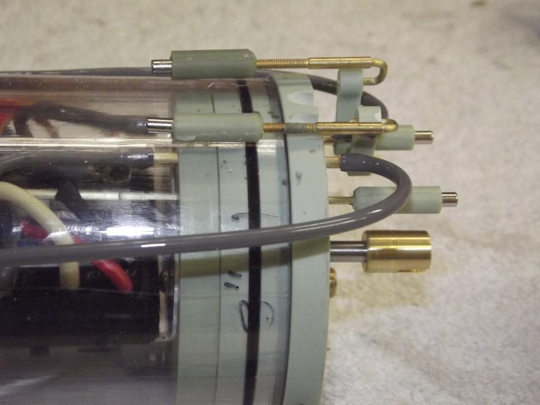

    And sometimes, for the smaller models, a length of flexible hose will serve as coupler-universal joint.
