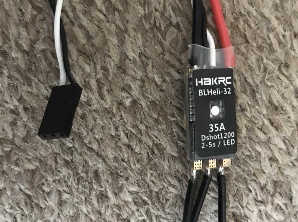

      High quality reversible ESC's can be had for about fiver ($6), and thanks to modern mosfets have a tiny footprint. Here you can see a Hak RC Blheli_32 esc. Next to it is the standard Futaba receiver plug it comes pre-wired with . As you can see the controller isn't much bigger, yet it's rated at 35A continuous at up to 5s lipo (18.5 volts), enough for most model submariners I think. So small footprint, they lack a BEC, which is a good thing in my view as built in BEC's are rarely adequate for subs. A standalone BEC of 3A rating can be had for about pound on ebay.

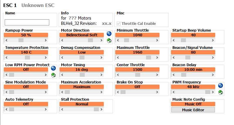

      To set up the ESC you use a free app. A typical window looks like this. In there you can set things like throttle points, bi-directional control, PWM frequency to the motor etc. I use an Arduino nano to chat with esc. I found it pretty easy, and I'm no computer geek.

        THAT is good stuff, Andy! Thanks. I trust the Boss-man is looking this over right now.
        That little brushless ESC would change my whole outlook on the subject.
