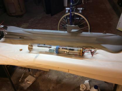

    I have had this sub in temperature controlled storage for over a decade. It was caught in a basement flood years ago, but managed to get it out after a day. The WTC never got wet,but has not been used in almost 10 years. The WTC is a DE 3 inch with graupner 400 motors each at 7.2volts. Technology has considerably changed since this sub was built. I plan on gutting the insides and re-do the lighting using leds. I also plan on changing the linkages to the WTC with the new Klikons. It seems to be a much better technology. I want to use the new lipo poly batteries, but I think I will need a battery cylinder for these to keep them from getting wet. she is going to get a bow light cage, new paint job, and other exterior fixes. My questions are these:
    1. Can you replace the seals on the DE Wtc where the servo arms leave the cylinder?
    2. If not, What size of new Subdriver to use on this boat?
    3. How to link up lights to the main battery?
    4. Which Llpopoly batteries to use, and how many?
    5. What balance charger does one use for the lipo poly batteries? Click image for larger version  Name:	7D3D0CDC-986E-4ED5-8E70-9B943E9311A3.jpeg Views:	1 Size:	17.7 KB ID:	126558
    Any help would be greatly appreciated!
    Here is a shot of the sub and WTC. I just pulled it out of storage today.

    I put this in the newbie section,because I am basically starting over.She does have David Merriman’s pump jets (circa 2001) and the sail he made for this boat. I am so happy I purchased these so many years ago!

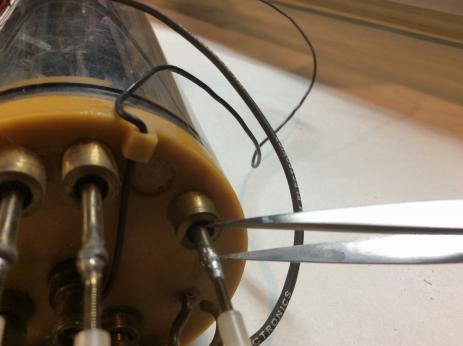

              Click image for larger version  Name:	763AD0A2-117F-4818-B4EE-376107A42310.jpeg Views:	1 Size:	19.0 KB ID:	126578
              Do you sell these seals Bob that the tweezers are pointing to? See photo: Inside brass.
              • Michael Laubach
                • Feb 2018
                • 66
                Does the whole brass housing with rubber seal come out and replace the whole thing?, or just the rubber seal? Please forgive me, for I have been out of this a while. You don’t know how much I appreciate y’alls help.

                    That seal, I believe, can be opened up and the o-ring inside can be replaced. The seal end is threaded and tightened down onto the o-ring. You can increase or decrease the friction applied to the pushrod shaft. These are old......if I am wrong on this someone will quickly correct me.
                      I think I do have a few of these old-style seals left somewhere. You're looking to replace three?
