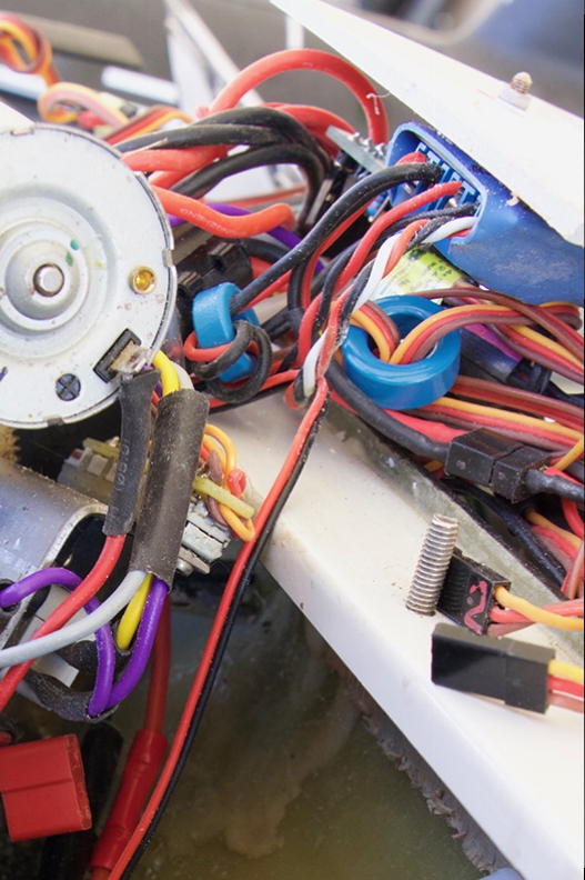

        Click image for larger version  Name:	Ferrite Rings.jpg Views:	1 Size:	322.0 KB ID:	120348
        The blue round donuts are ferrite rings used in my Engel Akula that I am working on. The practice is you wrap your wires (power or servo cables) around the ring 2 - 3 times. Then the Pixie Magic happens, it filters out high frequency noise. Here is a explanation from Wikipedia - "First, the ferrite concentrates the magnetic field, increases inductance and therefore reactance, which impedes or 'filters out' the noise." There clear as the muddy Mississippi river.

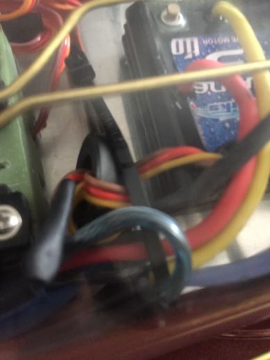

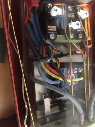

ID:	120354 Hi Phil, the ferrite ring is the grey ring that sits near the red positive lead coming out of the esc. I wound it round until the connector was close to the ferrite ring then made up an extension to run it down the PORT side and in front of the servos to the STBD side into the Rx. I have cable tied it down to stop it moving about. I included the esc wires as they were touching the control rods. Click image for larger version

            Very Cool Thanks

              Well done! Looks great!
