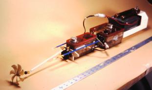

        Some old shots from my CO2 days. Note the use of the excellent single-stage Williams regulator -- developed for NASCAR pit-crews: Click image for larger version

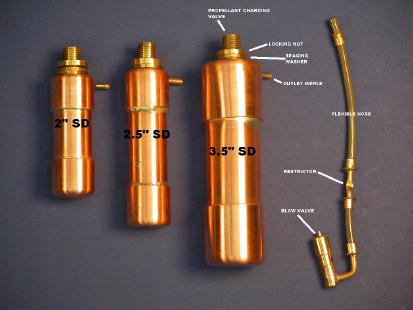

                            I'm not sure why a hydrostatic pressure test would be used on a tank that sees pressure under 100psi that Propel provides. Certainly, these small tanks have been manufactured by the hundreds by many people w/o being subject to certification testing. For example, these tanks appear to be manufactured in a very controlled environment by someone with the knowledge and skills to create a quality product-does anyone know if they were hydrostatically tested? Isn't there an inherent level of trust that some things are safe to use? Btw, I pumped this cylinder up with air in stages, releasing the pressure, and then increasing it again until I reached the maximum of my compressor. I had previously filled it with water and found no leaks. I considered filling it with water and freezing it over night but felt that it might actually cause the tire valve(which I consider to be the weakest part of this cylinder)to fail from the relentless expansion of ice, destroying its integrity without actually being able to measure its point of failure.

                              Those bottles pictured are for propel only. No hydro test. Just a function test (charged with propel and dunked in water, looking for leaks). That's all. The 'safety valve' on those is the flexible hose burst pressure of around 400 psi. No one's eaten a copper bottle yet.
