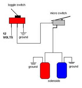

ID:	109959 solonoids would be the reverse polarity(counter rotating motors) if you want the motors turning the same direction wire them in series. Cant really see the small picture of the diagram so I dont know what the model number of the switch, I looked up MTroniks wire diagrams and there are quite a few varients in the immage section, I just picked this one for simplicity.
