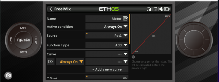

    Hi, for some reason I just can't figure out how to get reverse using the X18 transmitter. I am using a hobbywing 1060 speed controller which I have set in the forward and reverse setting. For a test I used channel one input and channel one output, using pot 1 to control. Ok I get the motor going one direction but not the other. I see that in the software there is a reverse switch, so I move that to on. All this does is ask for a second channel output. So how do I get reverse, does anyone know. Thanks

    Can you send a picture of that mix?
    It should look like this (Mix edit)
    Click image for larger version  Name:	Screenshot 2024-03-29 154939.png Views:	0 Size:	51.1 KB ID:	179116
    then scroll down...this shows the reverse switch "Off", as you said make sure that's "ON"

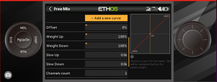

    Click image for larger version  Name:	Screenshot 2024-03-29 155027.png Views:	0 Size:	50.5 KB ID:	179117

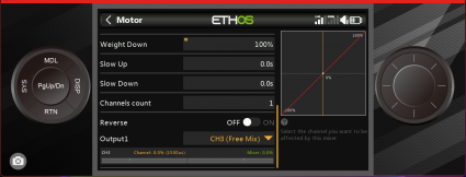

    Scrolling all the way.
    Click image for larger version  Name:	Screenshot 2024-03-29 155153.png Views:	0 Size:	49.5 KB ID:	179118
    Make sure the Transmitter Firmware is up to date.
    Center of the POT should be off (1500us). Not sure if you're curve is right, or the "Weight" up and down is equal.

      Hi, thanks for your reply. Well after spending fruitless hours trying to figure this problem out. It turned out to be the motors of the various pumps I was using. In the end I found one that turned in both directions.
